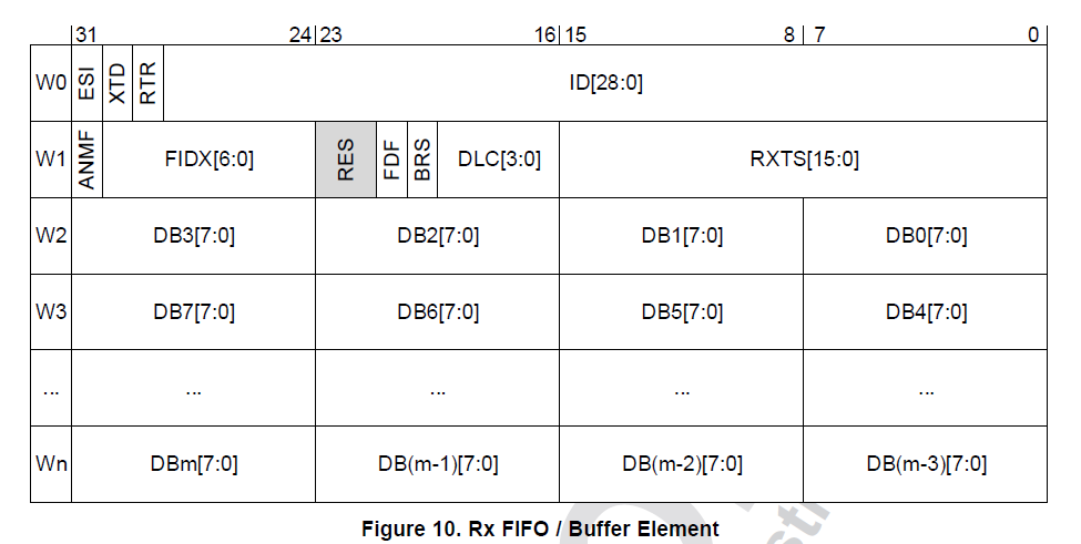

This is how the register looks in TCAN4550
Reading a word from TCAN4550 delivers the bytes from MSB to LSB and from W2 to Wn. Let's say TCAN receives a frame with 64 byte payload, such as byte_0 = 0, byte_1=1 byte_2 = 2 ...... byte_63 = 63.

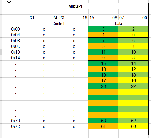

After reception, the MibSPI RAM looks like this:

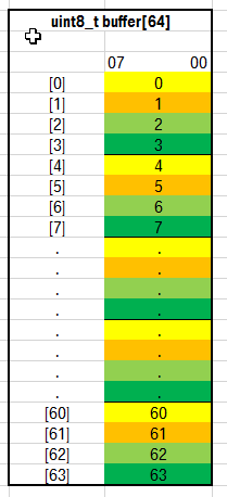

The frame buffer in the application should look like the frame sent on the CAN bus:
After reading the MibSPI and DMA manual I'd say it's not possible to program the DMA controller in a way that it re-orders the MibSPI-RAM into whatever is needed in RAM. Is that correct or is there a solution for it?
