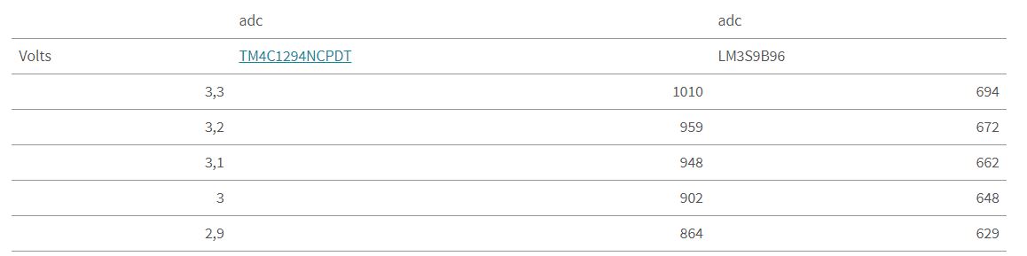

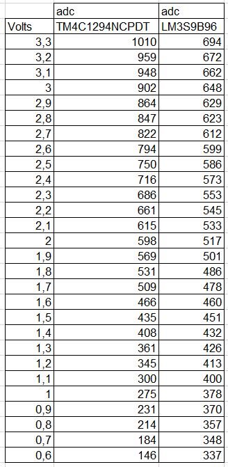

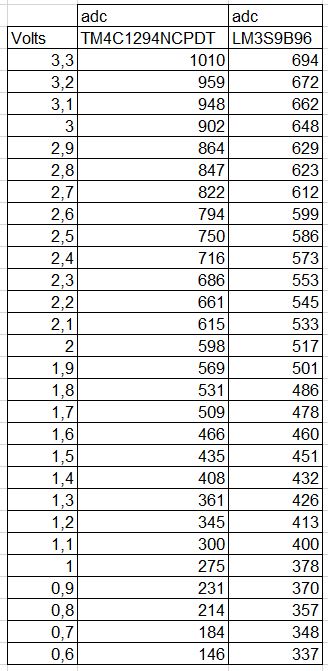

I did port LM3S9B96 to TM4C1294NCPDT , specially about the ADC. Looks like that I did everything ok, but I have a different conversion between the microcontrollers.
The only difference that I applied was a resistor on the adc input (TM4C1294NCPDT) as the doc says http://www.ti.com/lit/an/spma049a/spma049a.pdf
 re
Below I put the source codes and the reads tables, by the way I know that  LM3S9B96 works in 10bits and TM4C1294NCPDT works in 12bits, so I did the conversion just dividing by 4 the TM4C1294NCPDT results.
 Please take a look, and comment will be well come.
Best Regards.
adc
adc
Volts
TM4C1294NCPDT
LM3S9B96
3,3
1010
694
3,2
959
672
3,1
948
662
3
902
648
2,9
864
629
2,8
847
623
2,7
822
612
2,6
794
599
2,5
750
586
2,4
716
573
2,3
686
553
2,2
661
545
2,1
615
533
2
598
517
1,9
569
501
1,8
531
486
1,7
509
478
1,6
466
460
1,5
435
451
1,4
408
432
1,3
361
426
1,2
345
413
1,1
300
400
1
275
378
0,9
231
370
0,8
214
357
0,7
184
348
0,6
146
337

    Considering that the timer is correct, because as I could see , the timer is not the problem. It is working just fine, I already tested it (individual) and I know that is ok.
    The big deal that I imagine is about the ADC reference, for example in LM3S9B96 I am work in the standard mode, I mean I didn't setup any external reference for the voltage, and as I can see on manual, the internal reference is 3,3Volts or 3,0Volts. But If you take a look on the table you can see that when I have 3,3volts the conversion isn't the 1023 or next of this, considering that 3,3volts should be 1023 on the conversion ( 10 bits) but when I have 3,3vots the result is 694. Looks like that the reference is 5 volts, it is what the values on the table make me believe. But I didn't setup this 5 volts reference in any part of my code.
    For the other hand , when I look to the Tiva micro, I have 3,3 volts converted to adc equal to 4096 dividing by 4 means 1024 or as I putted on the table 1010 (because of the 470ohm resistor).
    Again my big deal is this differences between the reads - I guess that in general both system are working just fine, otherwise LM3S9B96 is converting ADC with a different reference.

    But this change doesn't reflect on the reading scale, I mean in the LM I have 3,3volts , adc = 694 , and in TIVA after div the result by 4, when I put 3,3Volts I have 1010 ~ 1023.
    The LM functions are very similar between StelarisWare and TivaWare as I could see, except about this ADC clock, that you already explain me.
    I also did check about the example on the Tivaware, In fact this my source code here for the TIVA is already based on a TivaWare example with small changes of course. As you said there were some small mistakes like the adc clock and the timer setup (because I did a mistake in copy and past the codes). But in general, It is just a test to check this adc conversion, I would comment the others adc ports on my code, but I guess that isn't the problem.
    As I said, looks like that both has a different volt reference , considering that in LM : 3v3 mean adc conversion = 694 (adc conversion), and Tiva in 3v3 is 1023 , the conversion in Tiva is correct on my point of view.
    For example:
    In LM:
    1023 ADC
    -------- = ------- So I have ADC = 675,18 (it next of 694 in my initial table). I see that in LM look like that the reference voltage is 5volts
    5volts 3,3(Vinput)
    In Tiva
    1023 = ADC
    ------ ------- So I have ADC = 1023 and the TIVA as I can see the reference is right it is 3,3votls.
    3,3V 3,3(Vinput)
    Obs: in Tiva the result is 4096 (12bits) but I am dividing by 4, so 1023.
    If you not only considere the code as we have been done until now. We can see that we have this difference. And also considering that the code of TIVA is correct because I did the measures using the input voltage , 3,3v to 0,6 volts and the conversion look like right and makes sense , as I can see in the table.
    Maybe there is a little mistake or difference in the behavior operation between LM and TIVA.
    But I would say that the ADC in TIVA is work as it should do.

    Perhaps you table is hard to read for me as the column titles (volts, TM4C129NCPDT and LM3S9B96) are not aligned to the data. I assume 1010 is for the TM4C129 column and 694 is for the LM3S column.
    >> Yes the table is a little bit shifted but it as you suppose, anyway I am attaching a picture to clarify it.
