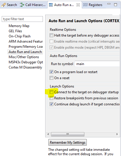

    From an application's view, the default behavior of the RST pin is the same as a power on reset. Therefore I strongly suspect the issue you are seeing is the difference in timing. I suspect that after a power-on, the TM4C starts executing before the GPS module is ready and the code either tries to initialize the GPS before it is ready, or gets stuck in some loop because the GPS signals were not in the expected state.  You can configure CCS so that it does not automatically connect to the target when it is launched and that it does not reset the device when it connects. This way you can start CCS, launch the target configuration, then power-on the system. Then you can connect and it will halt the CPU where it is. You can load symbols (not reprogramming the flash) to help identify where in the code the CPU is stuck.
