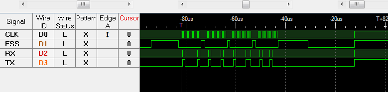

  • Here is a routine that sends some data out the SSI, then turns the pins into GPIO inputs. Finally, the pins are configured with pull-ups so you can see the effect in the logic analyzer picture.

        // Now configure the SPI pins as digital inputs
        GPIOPinTypeGPIOInput(GPIO_PORTB_BASE, GPIO_PIN_4 | GPIO_PIN_5 | GPIO_PIN_6 | GPIO_PIN_7);
        // Configure with pull-ups
        GPIOPadConfigSet(GPIO_PORTB_BASE, GPIO_PIN_4 | GPIO_PIN_5 | GPIO_PIN_6 | GPIO_PIN_7,
                         GPIO_STRENGTH_2MA, GPIO_PIN_TYPE_STD_WPU);
