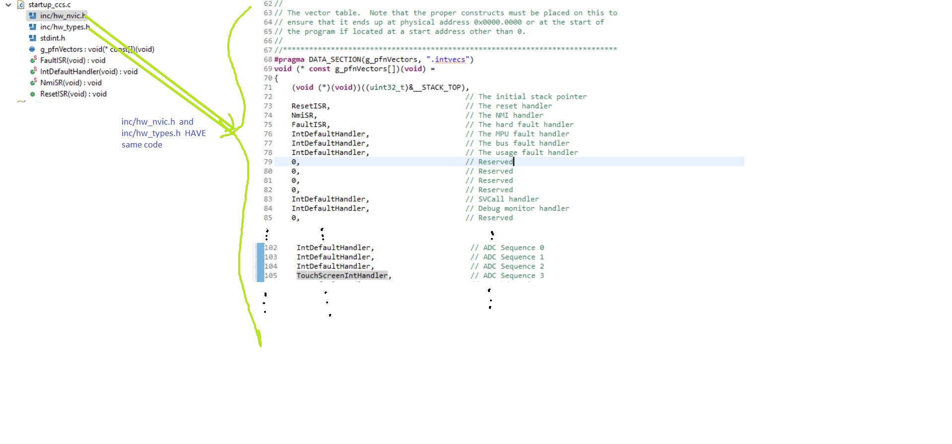

  •  Hello Derrick,
    "The "interrupt number" will correspond to an index in an interrupt table.
    Somewhere in the non-RTOS example will be a board support file which places the USB_ISR_Fxn() at a particular index. Additionally, you can refer to the Nested Vectored Interrupt Controller (NVIC) section of the datasheet. Based on the datasheet, I suspect you want interrupt 58 corresponding to USB MAC."
    Related to my LCD example, I found the NVIC table above.  In this case, the LCD  ISR is called TouchScreenIntHandler and it is attached to hardware interrupt ADC sequence 3 ( or vector number 65).  Is that what you meant?
    If it is, so for RTOS example; do I need just  to replace the " TouchScreenIntHandler" in the NVIC table by IntDefaultHandler (as all the other once) and make *.cfg file point to TouchScreenIntHandler function?
    Also why the same code appear in two different files (hw_nvic.h and hw_types.h) . I though this will generate an error such " .. redefined..". Of course here it didn't but I couldn't understand why.
    Also the RTOS projects haven't got NVIC table file attached to it. I know I can define my own ISR in the *.cfg file but what about the others one that I didn't need. What is their default state?
  • Hello Rab Boud,
    That is correct.
    For the RTOS example you need to perform the Hwi_create using the TouchScreenIniHandler as such:

    Not sure why the same code appears in hw_nvic.h and hw_types.h. Maybe someone from the TM4C can address that in a separate thread.

  • Thank you Derrick.
    At some point I will try to import the LCD example to RTOS  application by following these advice. I will let you know the results.
    Finger cross .
