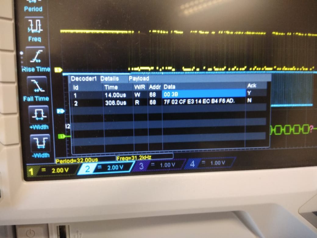

HI,
I tried to use i2c for communicating with MPU-6050 sensor.
I don't know where i'm going wrong. I'm getting same response from the sensor. I have checked with oscilloscope and getting the same data even after doing change in movements.
Here I'm attaching
1.my file used for i2c read and write.
2.Invensense register map document
3.image of oscilloscope.

#define PWMR_MGMT           0x6B
#define IMU_SENSOR         (0x68)
#define TASKSTACKSIZE       768
Task_Struct task0Struct;
Char task0Stack[TASKSTACKSIZE];
void writeRegister(I2C_Handle handle, uint16_t regAddr, uint16_t value)
    uint8_t             txBuffer[4];
    I2C_Transaction     i2cTransaction;
    i2cTransaction.slaveAddress = IMU_SENSOR;
    /* Write to a 16-bit status register */
    i2cTransaction.writeBuf = txBuffer;
    i2cTransaction.writeCount = 4;
    i2cTransaction.readCount = 0;
    txBuffer[0] = regAddr >> 8;   //HB Addr
    txBuffer[1] = regAddr & 0xFF; //LB Addr
    txBuffer[2] = value   & 0xFF;
    txBuffer[3] = value   >> 8;
    if (!I2C_transfer(handle, &i2cTransaction)) {
        GPIO_write(Board_LED1, Board_LED_ON);
        System_abort("Bad I2C transfer!");
void readRegister(I2C_Handle handle,
                  uint16_t regAddr,
                  uint8_t *data,
                  size_t   length)
    uint8_t             txBuffer[2];
    i2cTransaction.readBuf = data;
    i2cTransaction.writeCount = 2;
    i2cTransaction.readCount = length;
    txBuffer[0] = regAddr << 8;   //HB Addr
 *  ======== taskFxn ========
 *  Task for this function is created statically. See the project's .cfg file.
Void imuTask(UArg arg0, UArg arg1)
    I2C_Handle i2c;
    I2C_Params i2cParams;
    uint8_t data;
    /* Create I2C for usage */
    I2C_Params_init(&i2cParams);
    i2cParams.bitRate = I2C_400kHz;
    i2c = I2C_open(Board_I2C_NFC, &i2cParams);
    if (i2c == NULL)
        System_abort("Error Initializing I2C\n");
    else
        System_printf("I2C Initialized!\n");
    /* Reset the device and wait */
    writeRegister(i2c, PWMR_MGMT, 0);
    Task_sleep(1000);
    GPIO_write(Board_LED0, Board_LED_OFF);
    while (1)
        readRegister(i2c, 0x3B, &data, 14);
        System_flush();
        Task_sleep(1000);
    /* Deinitialized I2C */
    I2C_close(i2c);
    System_printf("I2C closed!\n");
    System_flush();
