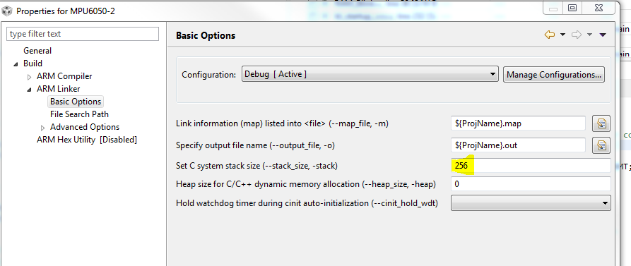

  • Change the stack size by modifying two things. First, right click on the project and select "Show Build Settings".  Expand the ARM Linker options, under Basic Options increase the stack size as shown.
    Second, change the same value at the end of the linker command file:
  • My original stack size was 2048 and I increased it to 4096.

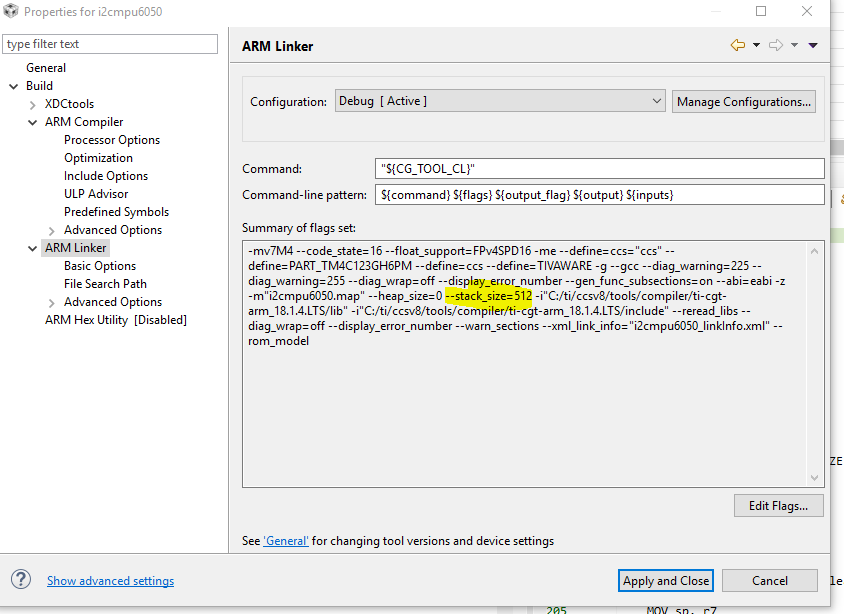

  • I see the issue that is preventing me from changing the stack size but I don't know what is causing it.
    My project link settings seem to be out of sync.
    This is the Summary of flags set from the "Show Build Settings..." panel.
    -mv7M4 --code_state=16 --float_support=FPv4SPD16 --abi=eabi -me -Ooff --advice:power="1,2,3,4,5.2,5.4,7,9,10,12" -g --gcc --define=ccs="ccs" --define=PART_TM4C1294NCPDT --define=TARGET_IS_TM4C129_RA0 --define=EK_TM4C129_BP1 --diag_warning=225 --diag_wrap=off --display_error_number --gen_func_subsections=on --ual -z -m"test.map" --stack_size=1024 --heap_size=2048 -i"C:/ti/ccsv8/tools/compiler/ti-cgt-arm_18.1.2.LTS/lib" -i"C:/ti/ccsv8/tools/compiler/ti-cgt-arm_18.1.2.LTS/include" --reread_libs --diag_wrap=off --display_error_number --warn_sections --xml_link_info="PoE_linkInfo.xml" --rom_model

  • When you build (compile and link) the project, do you use Code Composer to run the build (Project -> Build Project, or the "hammer" icon) or do you run an external make file? The .zip file as I received it did not have a "test.map" file in the debug directory. Instead it had a "enet_lwip_ccs.map" file. When I used Code Composer to build the project, I got a stack size of 1024 and a heap size of 2048, just as expected.
  • I do use CCS to build the project.  Event though I set the map file name to "test.map" it always names it "enet_lwip_ccs.map" and no mater what I set the stack size to the map file reports it as 800.

  • Let's try this. I renamed the project to PoE2 and exported it to the attached .zip file. Import this new project and build it. See if that gives the correct stack and heap sizes.
    /cfs-file/__key/communityserver-discussions-components-files/908/PoE2.zip
  • The imported project builds the correct stack size and also the correct map file name. I guess that my TFVC project has an issue.
