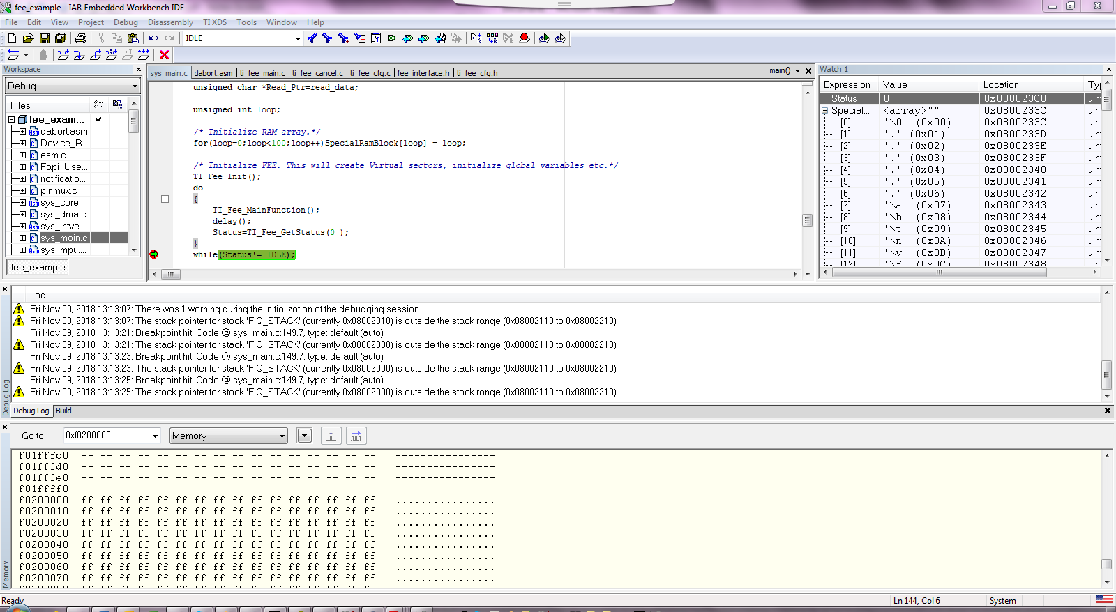

Hi.  I am trying to get the HALCoGen FEE example to work with the RM48 HDK (RM48L952ZWT).  The program loops forever waiting for the call to TI_Fee_GetStatus() to return IDLE.  It always returns 0.
The example is code is from: C:\ti\Hercules\HALCoGen\v04.07.00\examples\RM48x\example_TI_Fee_Write_Read.c
It is linked with the F021 little endian library recommended: F021_API_CortexR4_LE_V3D16.lib.

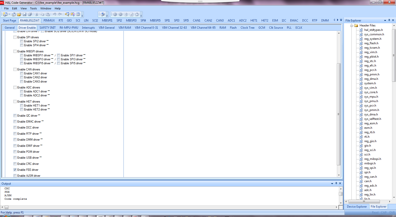

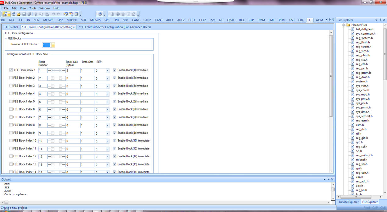

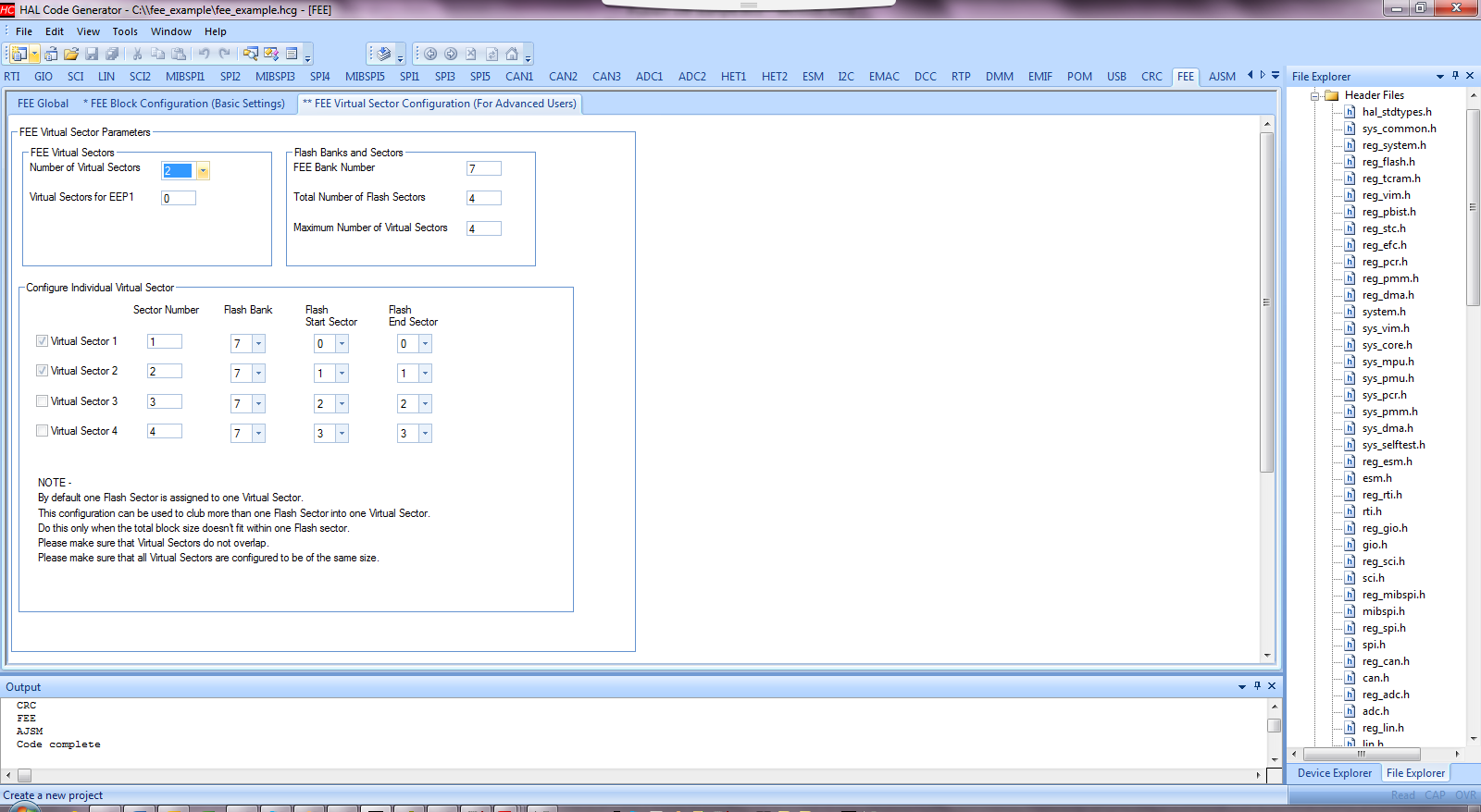

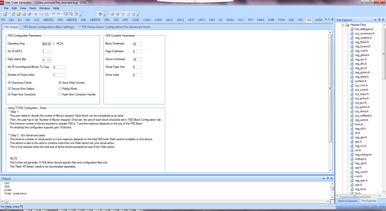

The relevant screen shots from HALCoGen are:
I am using the IAR IDE. The screen shot below shows point where the code loops forever.
Please recommend how I should proceed. I will need to save parameter data to flash in our target design and proving it can work on this demo board is necessary. Thank you.
  • Hi Shawn,
    Can you remove the delay in do-while() and try again?
    TI_Fee_Init();
    do
    TI_Fee_MainFunction();
    }while (TI_Fee_GetStatus(0) != IDLE);
    What is the MPU setting for FEE memory? Is it protected? What is the wait state settings for flash/EEPROM? Your CPU frequency is 220MHz, the ewait should not be less than 3. Please check the register: EEPROM_CONFIG
