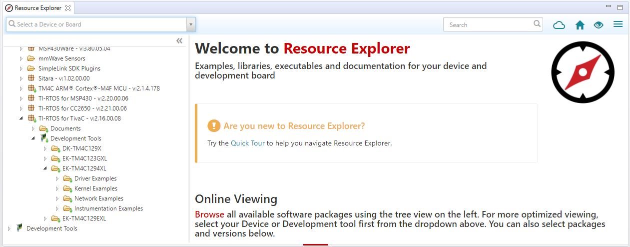

     Please refer to this Wiki link for IAR TI-RTOS support.
     If you are using CCS, you can import TI-RTOS examples from from CCS.
  • thanks for the reply.
    i saw examples that didnt use TI RTOS.
    what is the differece between uisng it and TI stellaris for example?

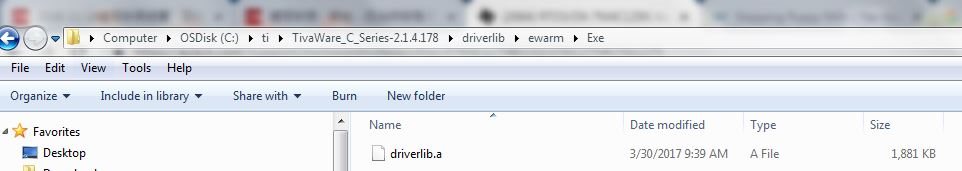

    i have IAR 8.32.1 and i downloaded the examples foe the IAR IDE, when i try to run it, i get linking error.
    "could not open file... driverlib.a"
    i didnt change anything and it didnt work.
    any ideas how to resolve this issue?
     First of all, if you are using the Tiva C series processor you should use the TivaWare library. The TivaWare can be downloaded from . The TivaWare libary contains the hardware peripheral drivers as well as examples, documentation, tools and many things else. The examples contained in the TivaWare are not TI-RTOS based. TI-RTOS is an real time operating system developed by TI. Many people can develop their application without the OS. It depends on your application needs. If you require TI_RTOS then the examples I showed you in my earlier reply are examples developed for the TI-RTOS. You can also reference them.
     For non-TIRTOS examples for IAR you can find the driverlib.a in the <TivaWare_Installation>/driverlib/ewarm/Exe/driverlib.a. I'm not familiar with IAR IDE. But in your IAR linker configuration/setup you will need to specify the driverlib.a as the library and the <TivaWare_Installation>/driverlib/ewarm/Exe as the searchpath.
  • thanks again for the response.
    i solved my linking problem. apparently the example uses project libraries inside the project and
    i have to run first driverlib and grlib in the example. they creat a driverlib,a  & glib.a files indise each Output folder of the sub project library.  only after that i need to run the main.c file.
