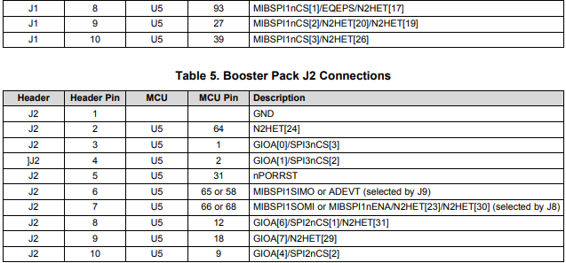

Hi all,
I am a beginner to embedded world. i was looking to code the pins of this microcontroller as mere gio pins and i am using halcogen.
1. I wanted to use J1 pin 8,9,10 and J2 PINS 3,4,7,8,9,10 as gio. there seems to be some conflict and i dont know how to use these. i am using halcogen to prepare my initialization code. i hope you guys can help me in this regard.
2. Does gioSetBit(hetPORTA1,24,1); work after putting checking dir,pdr,psl in halcogen. it isnt working. trying to pull n2het[24] pin high.
Thanks and Regards,
Nishanth A B
    To use J2 pins 3, 4, 8, 9, 10 you should do as follows:
    In HALCoGen:
    - In Driver Enable tab , uncheck Mark/Unmark all drivers checkbox;
    - In Driver Enable tab, check Enable GIO Driver;
    - In PINMUX tab, check GIOA checkbox;
    - In GIO tab configure pins (Input/Output/Pull-up/Pull-down and so on);
    - Generate Code (File --> Generate Code, or F5).
    In CCS:
    - call gioInit();
    Now you can use GIO functions from "gio.c". For example to set J2.10:
    gioSetBit(gioPORTA, 4, 1);
    To use J1 pins 8, 9, 10 and J2.7 as GIO you should do as follows:
    On the Launchpad:
    Put J8 on position 1-2 (to use SPI1SOMI, pin 66);
    In HALCoGen:
    - In Driver Enable tab, uncheck Mark/Unmark all drivers checkbox;
    - In Driver Enable tab, check Enable MIBSPI Driver;
    - In PINMUX tab, check MIBSPI1 checkbox (you can check GIOA as well, and configure GIOA port from GIO tab to use GIOA pins );
    - In MIBSPI1 tab-->MIBSPI1 Port, Configure all pins as GIO;
    -Generate Code (File --> Generate Code, or F5).
    In CCS:
    - call gioInit();
    - call mibspiInit();
    Noe you can use functions from gio.c to control those pins (using mibspiPORT1 as GIO port register pointer). For example, to set J2.10:
    gioSetBit(mibspiPORT1, 3, 1);
    MIro
