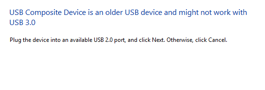

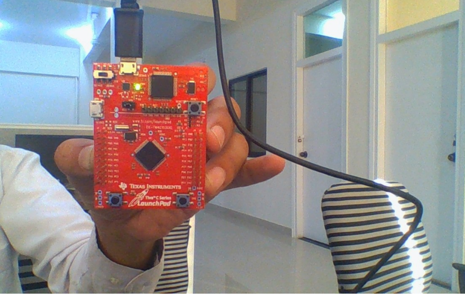

I have been trying for a week but my uniflash 4.50 is not detecting my device.I am using windows 10 .Same flashing when done on another computer using windows 10  is done but in my computer its not working.One day it automatically started working but now again it is creating a problem
  • I am unable to reproduce your problem. I am also using Windows 10, UniFlash 4.5.0 and an EK-TM4C123GXL launchpad. Are you able to connect manually? Are you able to connect and program the device using Code Composer Studio?

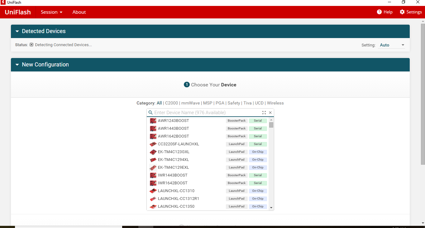

  • i donot know what the problem is .On friday after many failed attempts the program automatically started running without any issues but today again the same problem occured automatically.Now again this issue is resolved by itself i donot know why its really confusing.The real problem is uniflash cant even detect my connection that is "Stellaris in Circuit Debug interface".
    When error is persisting and i manually try to select the board and flash the program,this pop up appears"Ds property undefined".

    I really don't know what is happening in your environment; I tested this board in both Windows 10 1709 and 1809 but had no issues - I also used both USB2.0 and 3.0 ports.
    The error messages are somewhat troubling; it seems as if Uniflash wasn't able to install properly or something else in your system is either blocking or confusing Uniflash. Can you think if a configuration of your antivirus or firewall may be influencing this? Unfortunately the wide combination of tools and versions makes it impossible to test Uniflash on all scenarios.
    At the first connection using Uniflash, the screenshot below asks for permissions to Node.js. Did you grant permission for that?

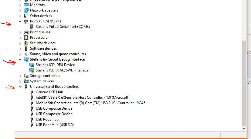

    - Maybe the existing Windows device drivers are old (a big maybe). What is the Stellaris ICDI DFU Device version on the Control Panel? Mine is 2.0.7922.0 from 31/12/2015.

  • As far as i know i granted all permissions that Uniflash wanted,when the problem was persisting I was also able to upload code through LM flash programmer.I am using the latest versions of ICDI drivers from the TI's Website.
