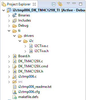

TM4C123BH6ZRB: I2C queue solution question
Part Number: TM4C123BH6ZRB
I design use I2C queue solution.
1.Can I create second I2C queue? If yes, how can do it?
2.Can I delete old queue message for I2C?
I need high priority from SWI do I2C command.
BR,
JK Wolf
  • Hi JK Wolf,
    Are you using TI-RTOS I2C Driver? If so:
    1. You cannot create a second queue, but you can use two separate I2C ports by opening each one individually. They will need to be on separate buses however.
    2. Deleting individual transactions is not supported, you can call I2C_cancel to remove all in progress/queued transactions assuming you are using the driver in callback mode.
    The I2C driver supports transfers queued in Swi's if the driver is in callback mode.
    Sean
  • hi Sean,
    Thanks for your reply,
    Yes, I am using TIRTOS I2C driver.
    I am use TI RTOS version "tirtos_tivac_2_14_04_31"
    What's version support I2C_cancel API ?
    I check Tiva TM4C123 isn't support ?
    if Tiva isn't support, how can I do cancel queu ?
    BR,
    JK
  • Unfortunately the cancel API was added after that release and is not supported for TivaC devices. However I look at the code and it seemed pretty trivial to add back to the Tiva driver. These files built and ran on TM4C129X so I expect they should work for you. Or at the very least it is a good starting point. Please note that since we are using a modified driver there may be unforseen issues.

    I2CTiva.h
    If you are using CCS you should be able to add it to your project like this:
    Hope it helps!
    Sean
