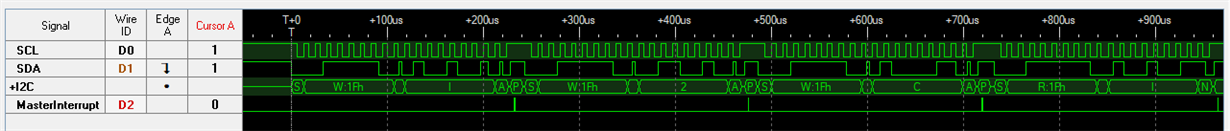

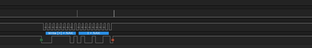

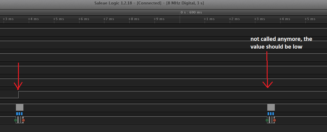

I want to trigger an i2c master interrupt on data interrupt and to verify if the interrupt has called i linked a pin to scope and i change the state of the pin on each interrupt call.
My interrupt seems to be called just once any idea why ?

Scope view:
