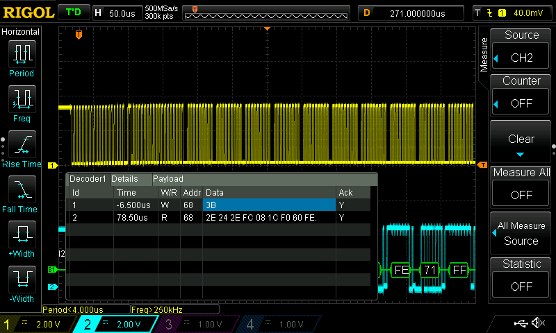

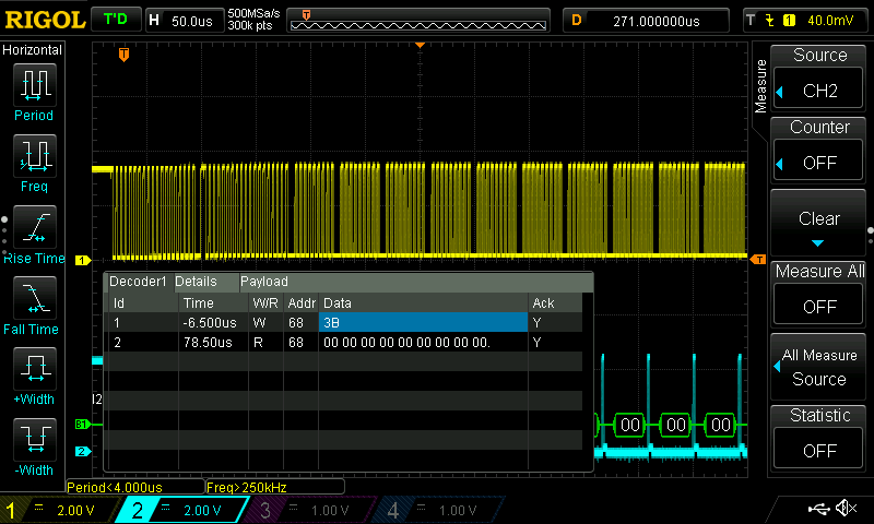

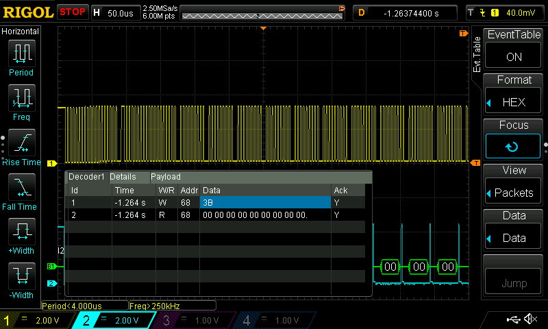

TM4C123GH6PM: I2C Communication not working on intial power up but works once debugged.
Part Number: TM4C123GH6PM
I2C is not reading registers on intial power up, but if i debugged once then its working as expected in all the next runs.
I'm using CCSv8.1, Windows 10, EK - TM4C123GXL
I2C0 Channel I'm using for I2C Communication.
I2C0 SCL - PB2
I2C0 SDA - PB3
Here i attached my code snippets:

I'm using TI-RTOS 2.16.00.08 for my project configured below function as Task to get the data from IMU Sensor:
void get_imu()
    I2C_Handle i2c;
    I2C_Params i2cParams;
    uint8_t pwr;
    pwr = 0x00;
    //Create I2C for usage
    I2C_Params_init(&i2cParams);
    i2cParams.bitRate = I2C_400kHz;
    i2c = I2C_open(IMU_SENSOR, &i2cParams);
    if (i2c == NULL)
        System_abort("Error Initializing I2C\n");
    else
        System_printf("I2C Initialized!\n");
    // Initialize the MPU6050
    writeRegister(i2c, 0x6B, 0x80, true);
    readRegister(i2c, 0x6B, &pwr, 1, true);
    do
    while (pwr & 0x40 != 0x40);
    // Use PLL with X axis gyroscope reference
    writeRegister(i2c, 0x6B, 0x01, true);
    // Enable I2C Master mode
    writeRegister(i2c, 0x6A, 0x20, true);
    // Set sample rate divider
    writeRegister(i2c, 0x19, 0x13, true);
    writeRegister(i2c, 0x67, 0x11, true);
    while (1)
        Semaphore_pend(IMUSem, BIOS_WAIT_FOREVER);
        readRegister(i2c, 0x3B, (uint8_t *) &signal.imu.mpu6050, 14, true);
