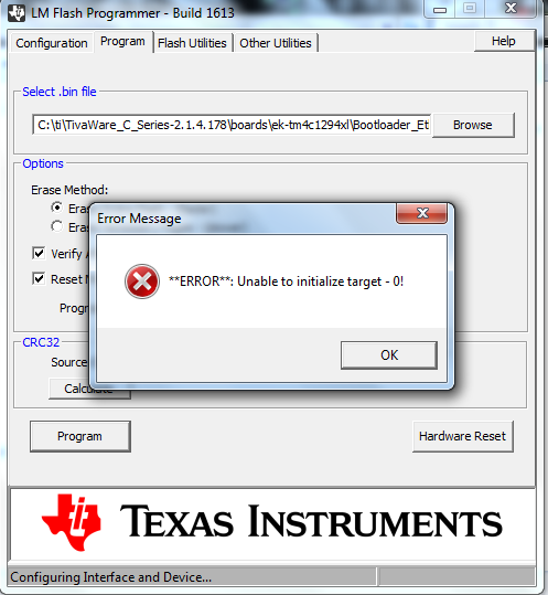

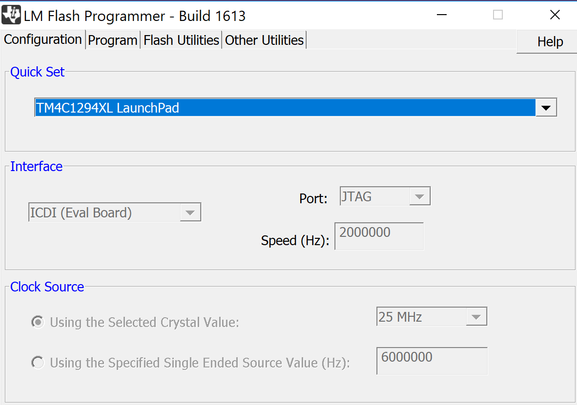

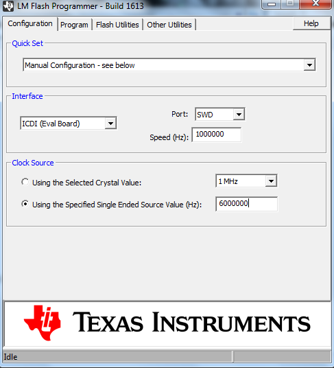

When i try to program the custom board is not getting programmed. I also unlocked the board using unlock from LM flash programmer.
Following are the LMFlash programmer screenshots.
What am i doing wrong? Please help.
