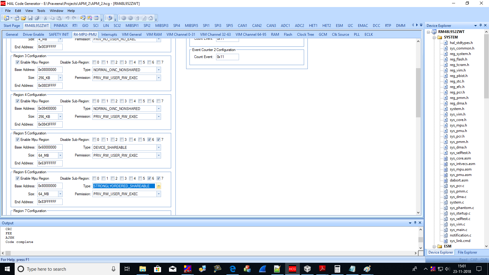

we are using RM48L952 in your project. we are facing issue with respect to accessing the external memory interface, for 1 address write 2 to 3 times write enable signal is going low.
we tried to configure external memory(EMIF) as a device memory , but Asynchronous 1 Configuration Register can configure only for normal mode or strobe select mode. we are facing problem regarding how to configure  external memory(EMIF) as a device memory.
Please find the attached configuration file of Halcogen, R4-MPU-PMU region, suggest us where to change for Device memory and let us know if any other configuration needs to be done.
we configured EMIF clock 25MHZ.
