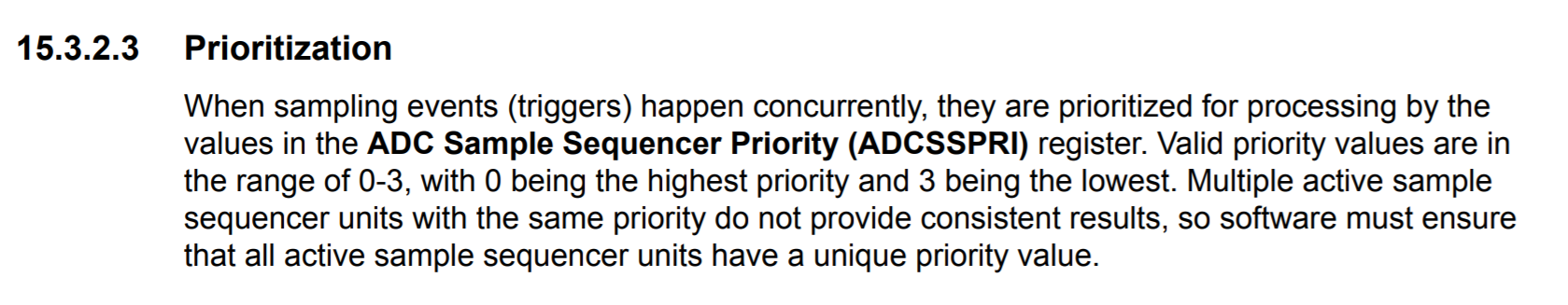

Is there any priority over SS0 - SS3?
In what order are SS0 - SS3 serviced?

  • It takes at least 500nS to do a single conversion.  When a sequence is triggered, it converts the channels in that sequence in order sequentially. Therefore you cannot have 4 channels in a sequence and trigger that sequence every 1uS. There is not enough time for all four conversions before the sequence is triggered again. Every second trigger would be ignored. In summary, the sample rate is based on the trigger rate but there must be enough time between triggers for all the configured samples to be completed.
    The priority is configurable as described in the datasheet.
