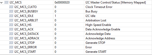

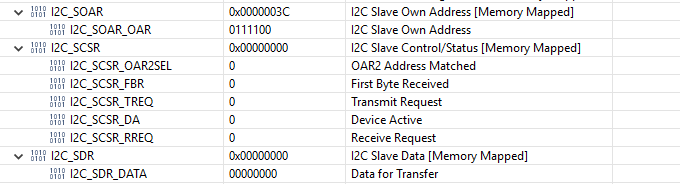

i have problem that all configuration is done except I2CMDR and I2CMCS are not modified even Iam writing to them
there Screenshots for all registers
