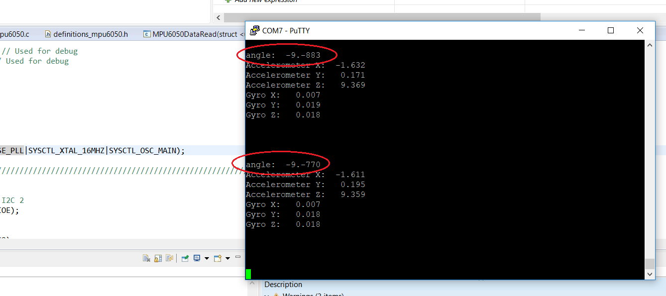

Everything works fine - except of on thing,
When the values of "angle" assume a negative value - the print of the (-) sign doesn't work well (a screenshot is attached)
Please help me fix the code.
  • Hello Shai,
    It looks like for the Angle you are missing the code you used in other places:
    shai kon said:
    if(i32FractionPart < 0)
                    i32FractionPart *= -1;
    For angle you only do this:
            i32IntegerPart = (int32_t)angle;
            i32FractionPart = (int32_t)(angle * 1000.0f);
            i32FractionPart = i32FractionPart - (i32IntegerPart * 1000);
            UARTprintf("angle: %3d.%03d\t\n", i32IntegerPart, i32FractionPart);
    So the minus sign of your last i32FractionPart operation isn't being taken care of.
