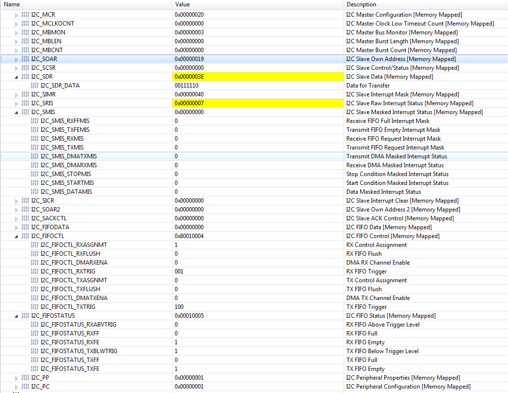

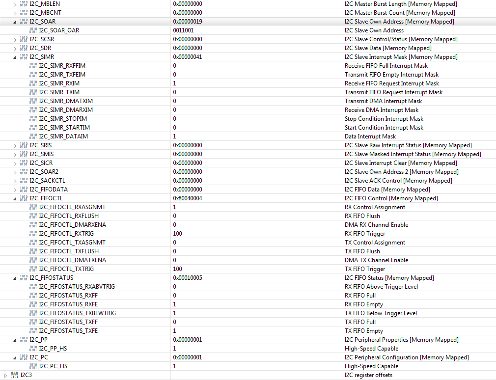

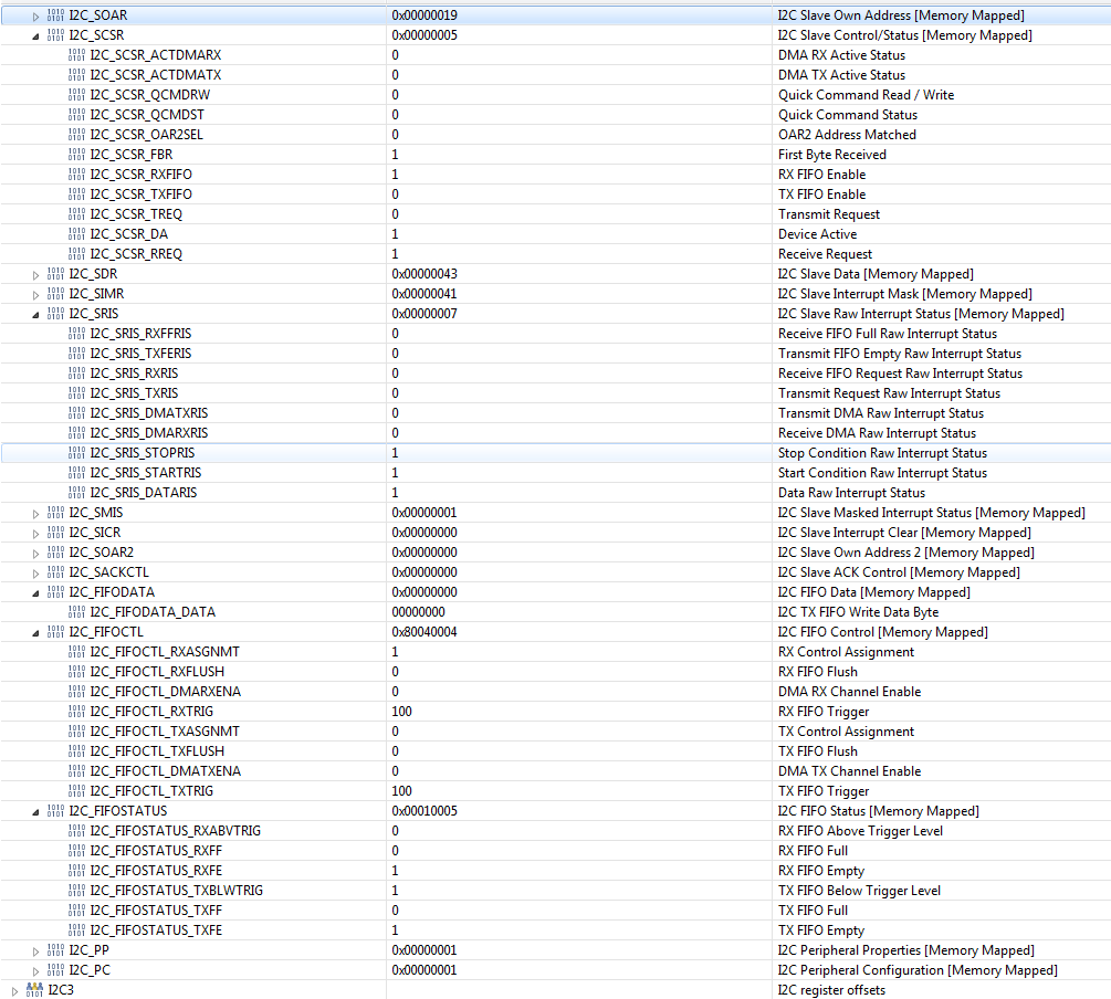

Hello everyone,
I have a problem regarding the configuration of TM4C1294 as a slave in I2C communication. In my project, it is communicating with other MCU (same type) which is master. I would like to configure this one as a slave which rises interrupt when a specific amount of bytes is received to the FIFO. For example, I first tried as with two, but I cannot get it to read data from FIFO. When checked in the debugger, the value is 0 when read with "nonblocking" or code blocks if it is read with blocking function. I suppose I did not configure MCU peripheral well. When I use single byte receive it works good, but I would rather use FIFO since messages transmitted between MCU-s will be of 2-3 bytes length. Here is my code for the slave MCU:
