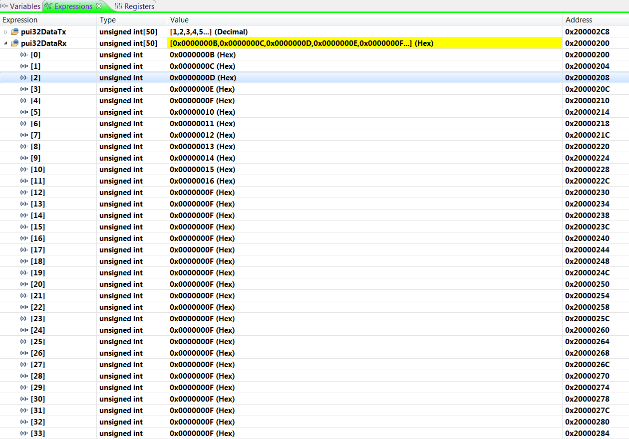

Hello all,
How to implement SPI Communication using two TM4c123gh6pm boards (one as master and other as slave) on a single PC?
I have configured one Tm4c123gh6m board as master and other board as slave and written two c++ script using code composer studio.
i successfully transferred 10 bytes of data [1,2,3,4,5,6,7,8,9,10] from the master end and received at the slave side.
After that i am sending  10 byte of data [11,12,13,14,15,16,17,18,19,20] from slave then i am getting following 10 bytes of data  at master side
[11,12,13,14,15,16,17,18,0,0]. I am using PUTTY to monitor master and slave data using two serial windows on single PC.
I am unable to receiving last two bytes of data properly at master side.
Here is my PUTTY serial windows
Please help me if anyone knows. It would great appreciation if you help others.
  • Hello Neelakar,
    Have you checked via breakpoints if you are receiving the SPI data in your master but perhaps the issue is outputting to the terminal?
    Also, are these projects on LaunchPads? If so, can you provide the projects? I can review the code if so.
  • Hello Jacobi,
    Please find the master and slave code below.

    // Configure SSI2 in Master TI mode.  This example will send out 10 bytes of
    // data, then wait for 3 bytes of data to come in.  This will all be done using
    // the interrupt method.
    void
    InitSSI2(void)

        while(SSIDataGetNonBlocking(SSI2_BASE, &pui32DataRx[0]))
    // Interrupt handler for SSI2 peripheral in slave mode.  It reads the interrupt
    // status and if the interrupt is fired by a RX time out interrupt it reads the
    // SSI2 RX FIFO and increments a counter to tell the main loop that RX timeout
    // interrupt was fired.
    void SSI2IntHandler(void)
        uint32_t ulStatus, ui32Index;
        // Read interrupt status.
        ulStatus = SSIIntStatus(SSI2_BASE, 1);
        // Check the reason for the interrupt.
        if((ulStatus & SSI_RXTO) == SSI_RXTO)
    	// Clear the interrupt
            SSIIntClear(SSI2_BASE, SSI_RXTO);
    	// Receive First byte from SSI2 Bus
            SSIDataGetNonBlocking(SSI2_BASE, &pui32DataRx[0]);
    	// Check first byte is valid or not
            if(pui32DataRx[0] == 11)
                // Receive 10 bytes of data from SSI2 Bus
                for(ui32Index = 1; ui32Index < NUM_SSI_DATA; ui32Index++)
                    // Receive the data using the "blocking" Get function. This function
                    // will wait until there is data in the receive FIFO before returning.
                    SSIDataGetNonBlocking(SSI2_BASE, &pui32DataRx[ui32Index]);
    	        // Wait until SSI2 is done receiving all the data in the receive FIFO.
                while(SSIBusy(SSI2_BASE))
    	   // Receive falg indiactes the reception is complted
               g_ulSSI2RXFF++;
            else
                while(SSIDataGetNonBlocking(SSI2_BASE, &ulDataRx0[0]))
    	    // Clear the receiver FIFO
                for(ui32Index = 0; ui32Index < NUM_SSI_DATA; ui32Index++)
                    pui32DataRx[ui32Index] = 0;
                g_ulSSI2RXFF = 0;
        // Clear interrupts.
        SSIIntClear(SSI2_BASE, ulStatus);

  • Hi Jacobi,
    Can we able to implement SPI Communication using TM4C123GH6PM ( one as master and other as slave ) borads ?
  • Hello Neelakar,
    I ran your code and did a little debugging to uncover the core issue. You are overrunning the RX FIFO.
    The RX FIFO is 8 bytes deep, and you are trying to fill it with 10 bytes of data.
    Using breakpoints, you can clearly see the Overrun interrupt flag for SSI2 is set via CCS View -> Registers -> SSI2.
    I attempted to remedy that issue by using SSI_RXFF instead of SSI_RXTO for your Interrupt, however that exposes flaws with your program methodology that are application specific.
    When using the RXFF interrupt, the checks you run for the FIFO contents cause the data to be cleared as multiple interrupts are required to process your data.
    I had to make a number of modifications to get the desired results, but they aren't really all that great. I think you need to re-think your approach in terms of how you process the received data. But in any case, hopefully this will get you going correctly, I am posting the modified  code for the master side (didn't have to change slave side) below:

    When i ran this ISR code in my PC i am able to getting following values in the pui32DataRx buffer.
    [11,12,13,14,15,16,17,18,19,20,21,22,f,f,f,f,f,.....,31,32].
    Could you please tell me why i am getting junk values in between ?
    Thanks and regards,
    Neelakar
  •   Hello Jacobi,
    Please find the output of pui32DataRx buffer values in below.
  • Hello Neeklakar,
    Can you post your latest c files? The last code you sent wasn't set to send that many bytes. I have a suspicion that the data on the SPI lines will show the 0x0F that appears in your register and if so it would be due to how the slave attempts to send data back but I can't know for sure until I test it out with the full code.

    void
    Ask (void)
        uint32_t count = 0;
        if(g_ulSSI2RXFF)
            for(count = 0; count < NUM_SSI_DATA; count++)
             //   g_ulDataTx0[count]  =  pui32DataRx[count] + 10;
            // Display the data that SSI0 received.
            UARTprintf("pui32DataRx[%d] = %d \n", count,pui32DataRx[count]);
            UARTprintf("SPI Slave Receiving is Done....\n\n");
         //   g_ulSSI2RXFF = 0;
    // Main function entry starts here
    int
    main(void)
            // Set the clocking to run directly from the external crystal/oscillator.
            SysCtlClockSet(SYSCTL_SYSDIV_4 | SYSCTL_USE_OSC | SYSCTL_OSC_MAIN |
                           SYSCTL_XTAL_16MHZ);
            InitConsole();
            UARTprintf("\n\nSSI ->\n");
            UARTprintf("  Mode: TI\n");
            UARTprintf("  Data: 8-bit\n\n");
                g_ulDataTx0[count] = count + 11;
            InitSSI2();
            IntEnable(INT_SSI2);
            IntMasterEnable();
            while(1)
                Ask();
                if(g_ulSSI2RXFF)
                Send(g_ulDataTx0);
                g_ulSSI2RXFF = 0;
    Thanks and Regards,
    Neelakar
  • Hello Neelakar,
    Thank you for sharing again, I have been tinkering with your code a bit but really the logic flow as a whole is very flawed and that is causing the issues. The device is completely capable of what you want to do, but your process is not structured well and has many points where the code gets stuck just sending or receiving data without being able to trigger a proper loop back per your requirements.
    My biggest concern looking at the current state is that you are using a blocking command in a for loop in an ISR. That means you are locking yourself in an ISR for a very long period of time. This is a very bad practice. ISR's are supposed to execute very quickly and then be done.
    But beyond that, you need to figure out a more robust means to check the data received and determine if it's valid. Especially given you want to deal with random bytes sent and your code is still relying on receiving specific bytes to start and when it gets out of sync, it has no means to recover.
    Frankly you need to re-write this code from the ground up to properly handle SPI transactions.
    Here are some suggestions to get you headed in the right path:
    1) Make sure you only send once, and then wait until you receive to send again. Even if that's not 100% your need, do that to start with because it will help you massively build a foundation you can add more advanced features to. This way you can control when you are receiving data and build a proper program flow.
    2) Use the ISR to receive what data is available, set a flag that data has been received, and exit it. Handle checking what the data is, how much has been received, whether it's valid etc. in a data processing function outside of your ISR.
    3) Have a robust means to reset your setup when you receive the wrong data. Clear the buffer, flags, etc. so you can be sure the next time a data send is triggered, it will re-fill your buffer from position 0. Also on the master side, reset your data sent to be your counted array so if you received garbage data your master isn't stuck forever with bad data.
    I hope these pointers will help you with re-drawing up how your application works. If you happen to know anyone in your company who has experience with firmware architecture, I would recommend seeking their advice as well. I know when I start I didn't know how to properly handle applications like this, but learned from mentors, this may be a good chance for you to do same.
  • Hello Jacobi,
    Thank you so much for your suggestions.
    Thanks and Regards,
    Neelakar
