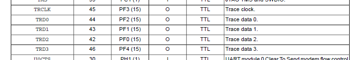

I have a doubt regarding the trace pins available in TM4C1294KCPDT.
I would like to capture the trace information for the code in the tm4c board(custom board).

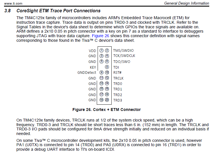

Question 1: Is it possible to get the trace information using the 10-pin JTAG connector or should i go for the 20-pin ETM+debug connector.
Question 2: If I  go with the 20-pin ETM+debug connector to capture the trace information , what are the pins that can be configured for trace clock and trace data pins in the micro-controller that can be connected to the debug connector?
