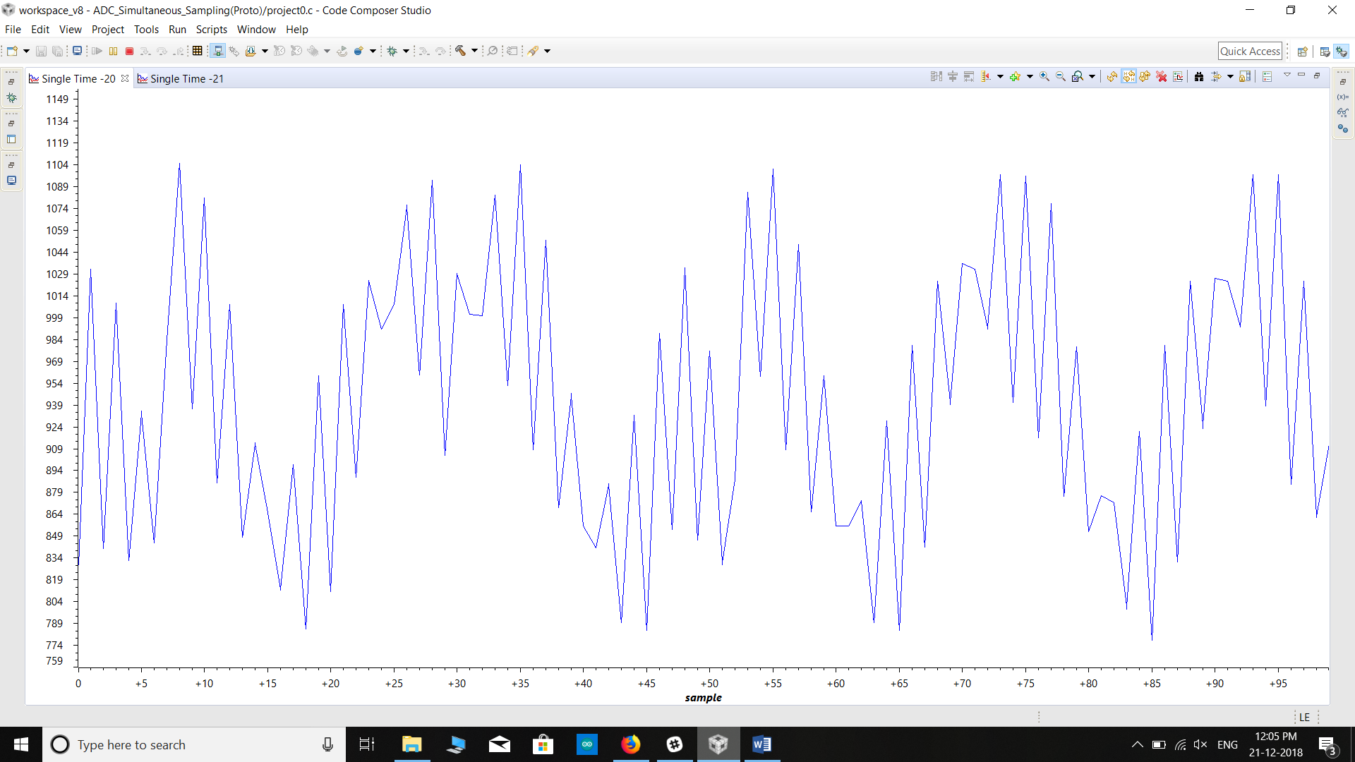

    Thankyou Sir. I was able to sample using both the ADCs. This is my current code. But I am observing distortion in the sampled signals and I am unable to figure out the reason.
  • Update: Sir, I was able to get an approximate reconstructed signal but I am getting delay between two output of the ADC. Is there any way I could minimise the delay between both outputs? Because currently I am getting significant delay between the two.

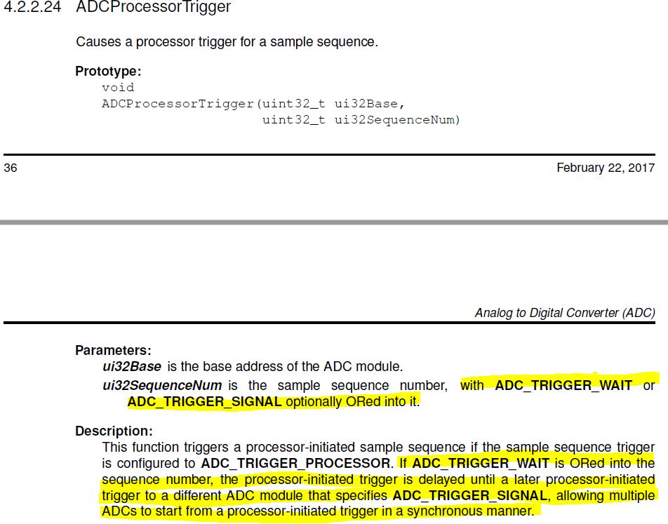

  • You setup the timer, but then used "ADCProcessorTrigger()" in your loop, and you did not use "ADC_TRIGGER_WAIT". For simple CPU trigger of simultaneous conversions the sequence is more like this:
                    ADCProcessorTrigger(ADC0_BASE, 3 | ADC_TRIGGER_WAIT); // Setup the trigger but wait.
                    ADCProcessorTrigger(ADC1_BASE, 3);                    // Trigger both ADC's

  • Actually, you should be stuck in the while loop waiting for ADC0. You need to add "ADC_TRIGGER_SIGNAL" to the "ADCProcessorTrigger(ADC1_BASE, 3);" statement. I have attached an example .zip project that does 5 simultaneous conversions of channels AIN0 and AIN1. Use the code composer "File" "Import" function to add this project to your workspace.

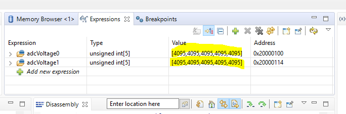

  • Update: I was able to do the simultaneous sampling. But when I used 3.3V as the reference voltage(DC), theoretically I expected a straightline around 4100 in the graphy but I see a straight line around 500. I cannot determine the problem for this.
  • Check you connections. I got the expected 4095.
