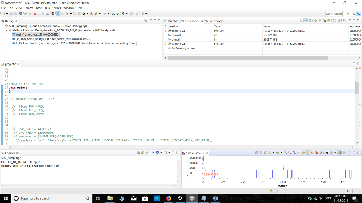

I am facing certain problem during debugging. Here, I am generating a signal in a pin of the MCU and then sampling the signal using the ADC.
I get to warnings which seem to have some effect in my code.
#112-D statement is unreachable    project.c    /ADC_Sampling2    line 66    C/C++ Problem
#169-D argument of type "unsigned long" is incompatible with parameter of type "uint32_t *"    project.c    /ADC_Sampling2    line 91    C/C++ Problem
#177-D subscript out of range    project.c    /ADC_Sampling2    line 91    C/C++ Problem
I am not sure why I get those warning. Secondly, during the graphical analysis I am seeing a irrelavantpeak rise, causes unknown. I am attaching the graph image.

    Clearing up the several warnings would be the first step would it not? The first one 112-D is a code killer, 169-D integer type mismatch must be corrected, 177-D subscript # is set incorrectly in the array.
    Double click on the warning in CCS Problems tab left view pane will take you to the code in error.
  • I am getting #112-D statement is unreachable project.c /ADC_Sampling2 line 66 C/C++ Problem for
    GPIOPinTypeADC(GPIO_PORTE_BASE, GPIO_PIN_3);
    and I am unable to find it's cause.

  • The statement on line 56:
      while(1);
    This puts the CPU into an infinite branch to self (doing nothing). None of the rest of the statements are executed. I think you should delete that line.

    Currently, in this code there are no errors or warnings. But I am still getting the peak overshoot which I had mentioned earliier and I am unable to fix it.
