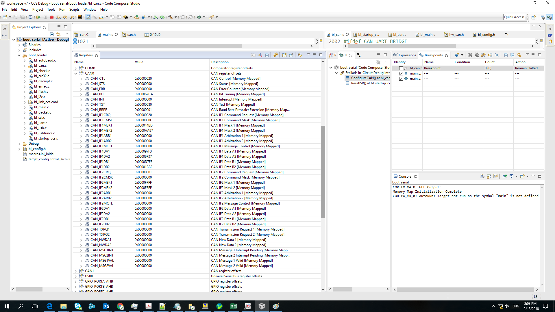

I am using EK-TM4C1294XL Kit to built an application and i success to built this application but, now i need to flash my kit over can bus so i decided to use Ti bootloader  according to TivaWare™ Boot Loader Document i update Serial boot example located at "ti\TivaWare_C_Series-2.1.4.178\examples\boards\ek-tm4c1294xl\boot_serial"  to use CAN bus 0 instead of UART but i can't transmit or receive any data over this bus . below show the updates which i apply on bl_config.h file

    we create other CAN node"CAN programmer"  using driverlib CAN functions with the same bit timing configuration we apply at target node CAN programmer node  sent "LM_API_UPD_PING" command to the target node and wait any feedback "LM_API_UPD_PING" from target node .By monitoring this CAN bus using USB to CAN parser and we just receive "LM_API_UPD_PING" command which sent from CAN programmer node to test the communication status with target node and by debugging bootloader code flashed on target node we received nothing at target node so we can't receive any data on this node .
    we update void UpdaterCAN(void) function at bl_can.c file as following i replace ui32Cmd = PacketRead(g_pui8CommandBuffer, &ui32Bytes); line by ui32Cmd =0;  just for testing transmit function and nothing are transmit on the bus .
    waiting for you support !!!

    are you have any idea about the reason which make the same function work at the application we built using driverlib.lib and not work with Serial-boot example . attached image shown the registers value of CAN0 at both cases we notice that registers have the same values at both cases .
    CAN_APP registers Value :
    Serial_boot CAN0 registers values:
    Thanks !!!
  • No, I don't know why you are seeing a different behavior. You did not mention the value of CRYSTAL_FREQ. Is it 25000000? Also, why do you use the PLL to get 25MHz when you are using a 25MHz crystal?
