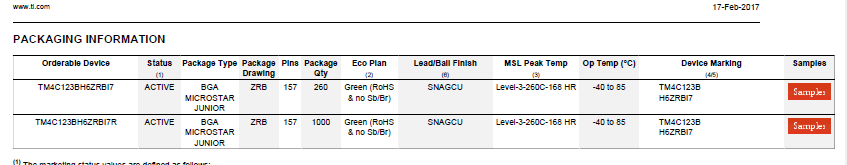

TM4C123BH6ZRB: Does the device have temperature rating fro -40 to 105
Guru 66310 points
Part Number: TM4C123BH6ZRB
Hello Champs
In the section A.1 of  data sheet, it mentions that the device may have different temperature rating: -40 to 85(I) or -40 to 105(T).
But in the orderable devices list, it only has the I version and there is no T version.
Does the TM4C123BH6ZRB have orderable part for the -40 to 105 rating?
Yihe
