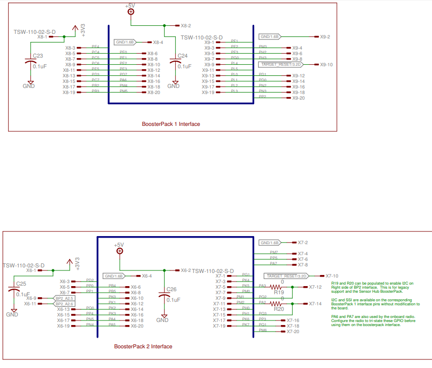

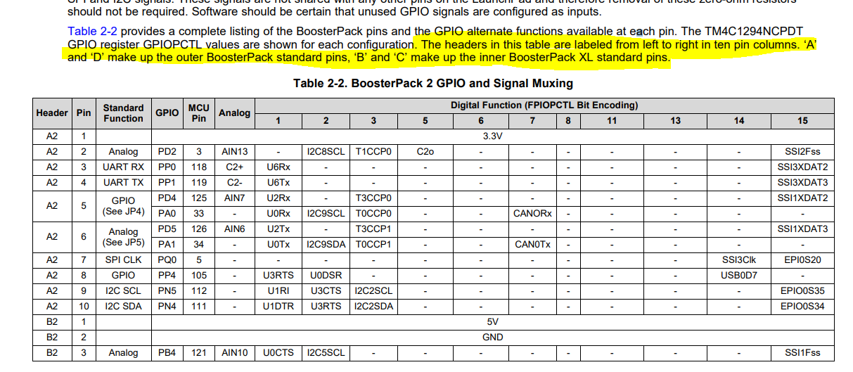

I have some trouble in figuring out the pin out for the booster pack. i am trying to match the X6 and X7 with the A,B,C,D mentioned in the table 2-2 (image attached).
  • Hello Harini,
    X6/X7 is a pair of BoosterPack heads which corresponds to the signals on Table 2-2. A2, B2, C2, and D2 are all on X6/X7. So you would look at BoosterPack Interface 2. The pins columns left to right are going to be A2 and B2 for X6 and C2 and D2 for X7.
