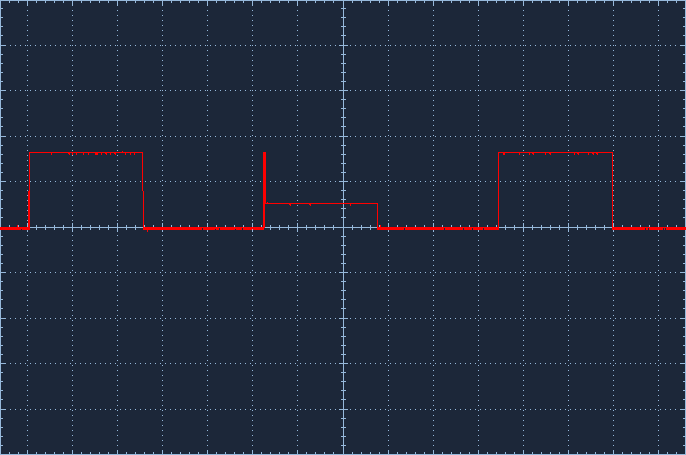

The PB6 of TM4C1231E6PM is configured as output. The pin is driving mosfet BSS138 that tuns on/off a relay.
ROM_SysCtlPeripheralEnable(SYSCTL_PERIPH_GPIOB);
ROM_GPIOPinTypeGPIOOutput(GPIO_PORTB_BASE,GPIO_PIN_6 );
The output has an aleatory behavior. Most of the times the High Output is, as expected, 3.3V. But sometimes it's 1.1V which cause the relay to remain off.
I checked the supply behavior with a scope and is consistently  3.3V.
I have been try to find the bug for some days.

  • When the problem occurs, what is the voltage on each side of the current limiting resistor? If the voltage is the same on both sides (1.1V) can you connect to the device with Code Composer Studio and display the GPIOB registers? Verify that GPIO_DIR still shows pin PB6 as an output.
  • Dear Bob
    The voltage is 1.06V an 0.96V  ( i.e. 0.1V voltage drop) in each side if the limiting resistor.
    I noted that the problem doesn't occur when the relay is no load in the contacts.
    I verified the GPIO_DIR and the pin still shows as output.
    This is the fault as seen in the scope.
    Ysaac
  • It looks like some of the ESD protection circuit on PB6 is being activated. You might zoom in your scope on the rising edge of the failing condition. (Getting a proper scope ground is critical.) Is a kickback from the load switch causing the pin to momentarily drop below ground or above Vdd? Is it causing a particularly fast rise time (< 2nS)?

  • This does look like susceptibility to radiated emissions. Do you have wires that connect to the micro and go off board? If so, replace them with twisted pairs, the other wire grounded.
  • I replaced the cable with twisted pair an doesn't solve the problem.
    I put a 100n capacitor between the gpio pin and GND and is working so far. I don't know exactly why it works but it seems that capacitor adds kind of transient suppressor.
  • Part of the ESD protection on the I/O pins reacts to fast rise times. It is possible that the RC created by the capacitor reduced the rise time of the induced noise so that the protection circuit is no longer firing. If it continues to work well, you have a solution.
