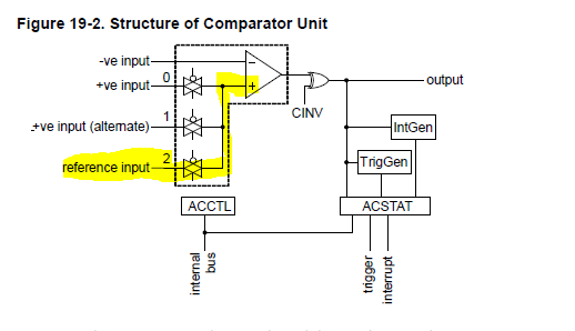

hello, I am writing the code for the analog comparator in which potentiometer is used as the external reference and in the handler of comparator I have to read the value of the comparator. please, anyone can help me to solve it out? my code is not going in the interrupt handler.

  • Did you edit the "startup_ccs.c" file and replace "IntDefaultHandler" with your interrupt routine "compinthandler"?
    apeksha said:
    ComparatorRefSet(COMP_BASE, COMP_REF_1_65V);
    ComparatorConfigure(COMP_BASE, 0,(COMP_TRIG_NONE| COMP_INT_BOTH |COMP_ASRCP_REF| COMP_OUTPUT_NORMAL));
    Also note your comparator is configured for internal VREF, not an external potentiometer.
  • i am comparing voltage from potentiometer to internal VREF. now it going in handler for zero volt but when i increase voltage its value is not changed.
  • That would be a very strange configuration unless only to check (Cn+ ASRCP) threshold crossing. Perhaps pots to much noise in movement need to have hysteresis? Please post simple drawing of your test circuit. With ASRCP it seems we must use Cn- inputs to your test signal. This case/s being true invert output may produce better results.
  • When using the internal reference, it is attached to the + side of the comparator. Your external input needs to be attached to the - side. Change to GPIO_PIN_7 in your call to GPIOPinTypeComparator() and move your external input to PC7.
