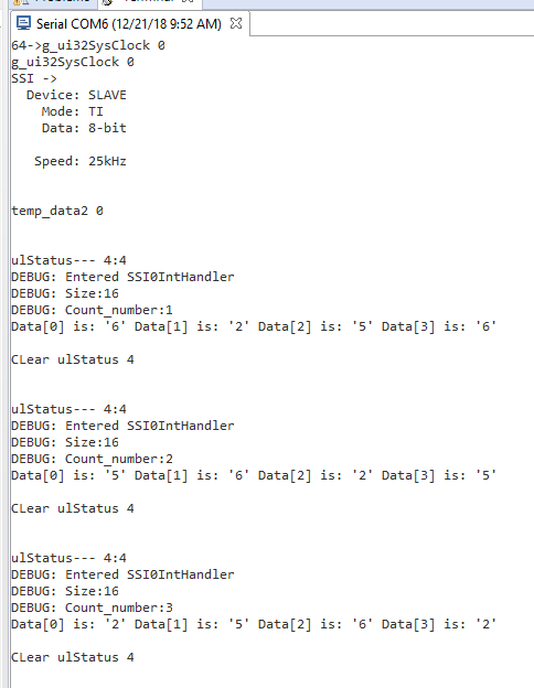

Hi, I am trying to use my EK-TM4C123GXL launch pad as a SSI/SPI slave device. I have tried some sample code based on an online resource which is using SSI0 Interrupts. When I tried sending data from my master (a Linux based platform) device to the launchpad, the SSI0IntHandler is not triggered and I am not seeing any received data.
I wonder if my code using interrupts to receive data is correct. Or there is a much simpler way to view the received data (I dont mind using the polling method) with sample code.
Note: My master is working fine as I am able to receive the data from it without any issues using an aardvark device as a slave. I have commented out  sendTxSSI() in my code.

	ulStatus = SSIIntStatus(SSI0_BASE, 1);
	// Check the reason for the interrupt.
//	if(ulStatus & SSI_RXFF)
	UARTprintf("\n\nulStatus--- %x:%x\n",ulStatus,ulStatus & SSI_RXFF);
//	if(ulStatus & SSI_RXTO)
		// Interrupt is because of RX time out.  So increment counter to tell
		// main loop that RX timeout interrupt occurred.
		// Read NUM_SSI_DATA bytes of data from SSI2 RX FIFO.
	//	SSIDataGet(SSI0_BASE, &g_ulDataRx1[0]);
	//	SSIDataPut(SSI0_BASE, 0x1111);//Dummy Write
		//sendTxSSI();
	while(!SSIDataGetNonBlocking(SSI0_BASE, &g_ulDataRx1[0]))
	while(!SSIDataGetNonBlocking(SSI0_BASE, &g_ulDataRx1[1]))
	while(!SSIDataGetNonBlocking(SSI0_BASE, &g_ulDataRx1[2]))
	while(!SSIDataGetNonBlocking(SSI0_BASE, &g_ulDataRx1[3]))
	g_ulSSI2RXTO = 1;
		//temp_data-=2;
		//SSIDataGet(SSI0_BASE, &g_ulDataRx2);
	// Clear interrupts.
	UARTprintf("\n\nCLear ulStatus %x\n",ulStatus);
	SSIIntClear(SSI0_BASE, ulStatus);

    SSIConfigSetExpClk(SSI0_BASE, SysCtlClockGet(), SSI_FRF_MOTO_MODE_0,
                       SSI_MODE_SLAVE, 25000, 8);
#endif
    // Enable the SSI0 module.
    SSIEnable(SSI0_BASE);
    SSIIntEnable(SSI0_BASE, SSI_RXFF);
       // SSIIntDisable(SSI0_BASE, SSI_TXFF);
    	SSIIntDisable(SSI0_BASE, SSI_TXEOT);
    	SSIIntDisable(SSI0_BASE, SSI_RXTO);
    	SSIIntDisable(SSI0_BASE, SSI_RXOR);
    SSIIntClear(SSI0_BASE, SSI_RXFF);
   // SSIIntClear(SSI0_BASE, SSI_TXFF);
    // SSIIntClear(SSI0_BASE, SSI_RXTO);
    //SSIIntClear(SSI0_BASE, SSI_RXOR);

  • Hello Gowtham,
    You are missing the SSIIntRegister API to associate your ISR handler with the SSI0 interrupt:
    SSIIntRegister(SSI0_BASE, SSI0IntHandler);
  • Hi Ralph,
    Thank you for the feedback. With SSIIntRegister(SSI0_BASE, SSI0IntHandler), I am able to receive data inside SSI0IntHandler. However, the received data is not accurate. When I transmit (Hex Data: 10,11,12,13) from the master, my receive data are either ( Dec Data: {6, 2, 5, 6} or {5,6,2,5} or {2,5,6,2} ). At times, only 2 or 3 data are received instead of all 4 data.
    I did some modification to the original code. Attached the modified code "receive_working_but_wrong_data.c" and the terminal output.

    	// Read interrupt status.
    		Count = Count + 1;
    		//SSIDataGet(SSI0_BASE, &g_ulDataRx1[0]);
    		//SSIDataPut(SSI0_BASE, 0x1111);//Dummy Write
    		//sendTxSSI();
    		UARTprintf("DEBUG: Entered SSI0IntHandler\n");
    		UARTprintf("DEBUG: Size:%d\n",sizeof g_ulDataRx1);
    		while(!SSIDataGetNonBlocking(SSI0_BASE, &g_ulDataRx1[0]));
    		UARTprintf("DEBUG: Count_number:%d\n",Count);
    		for(ui32Index = 0; ui32Index < 4; ui32Index++){
    		   // Receive the data using the "blocking" Get function. This function
    		   // will wait until there is data in the receive FIFO before returning.
    		   SSIDataGet(SSI0_BASE, &g_ulDataRx1[ui32Index]);
    		   // Since we are using 8-bit data, mask off the MSB.
    		   g_ulDataRx1[ui32Index] &= 0x00FF;
    		   // Display the data that SSI0 received.
    		   UARTprintf("Data[%d] is: '%d' ",ui32Index , g_ulDataRx1[ui32Index]);
    		g_ulSSI2RXTO = 1;
    		//temp_data-=2;
    	//SSIIntClear(SSI0_BASE, SSI_RXFF);

        // The "non-blocking" function checks if there is any data in the receive
        // FIFO and does not "hang" if there isn't.
        while(SSIDataGetNonBlocking(SSI0_BASE, &g_ulDataRx1[0]))
        // Initialize the data to send.
        //IntEnable(INT_SSI0);
        g_uc_timer = millis;
        UARTprintf("\ntemp_data2 %d\n",temp_data);
        while(1){
        	//UARTprintf("\n1.temp_data %d\n",temp_data);
        /*	if(g_ulSSI2RXTO != 0){
    			//UARTprintf("\nSEND DATA BACK TO MASTER\n");
    			//sendTxSSI();
        //return(0);
  • Hello Gowtham,
    I would suggest placing a scope or a logic analyzer on your SPI pins and seeing the waveforms at this point. You need to verify if the clock signal is at the expected frequency, and that the polarity settings for both master and slave are correct.
