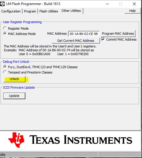

There is a unlock sequence given in which i have to use LM Flash programmer with ICDI driver to unlock the controller. So what are the causes that locks the controller in first place.

As i do not have launch pad , i can not perform unlock sequence. Looks like i have to change the controller and then test.
