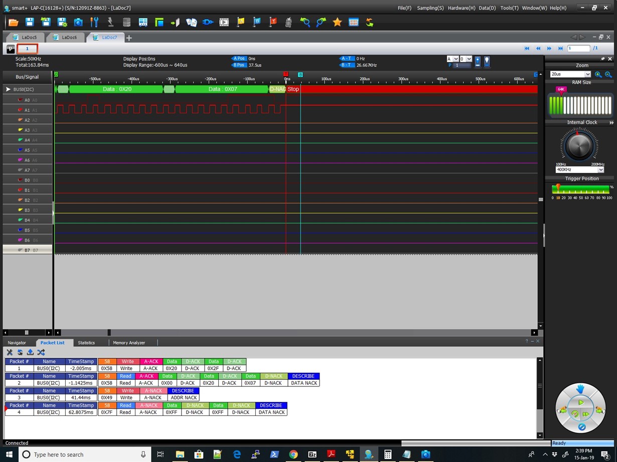

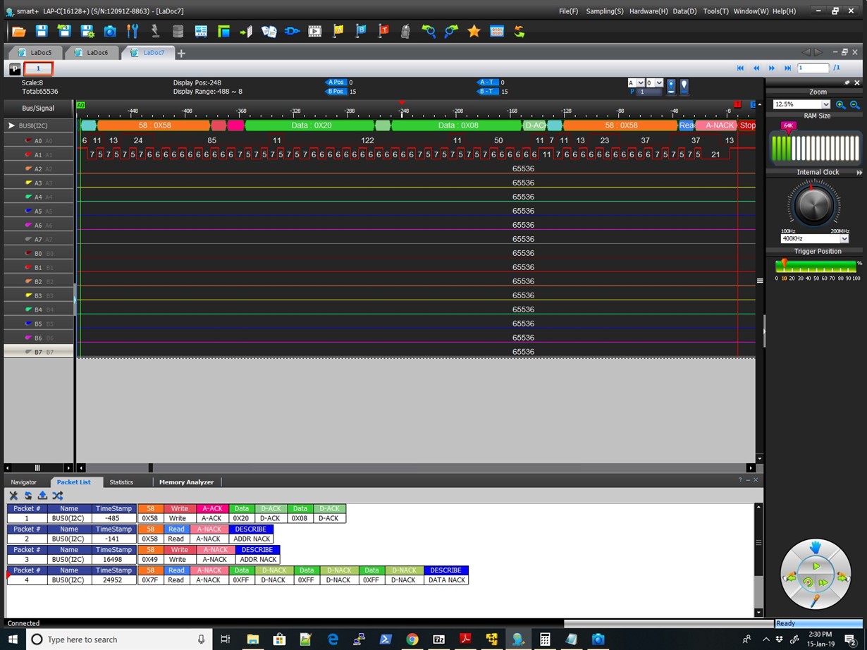

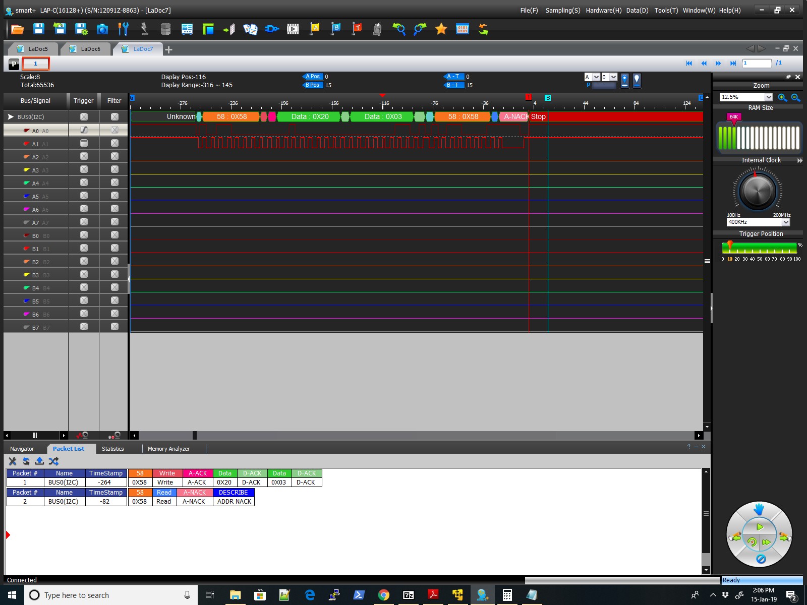

    When i compare i2c_transfer_start with i2c examples from cc430f5137 (single byte RX/TX and multibyte RX/TX) it seems to be same, unless i missed out something.
    I was able to get a digital osc by zeroplus. I have attached the three screen grabs , one is for init, read measurement and read features. I still have no idea why the nack.
    The screen shot below is for init:
    The screenshot below is for read measurements
    The screenshot below is for get features- this seems to return the correct value 0x0020 as per data sheet but i still see the nack.
    Any suggestions as to what i am missing?.
    NOTE: Please disregard the PACKET 3 and PACKET 4 in the screenshots, i have two more i2c devices (0x49,0x7F) which can be connected on the same bus externally since it is disconnected , it will be a nack.
    Thank you
    Kumar

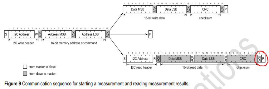

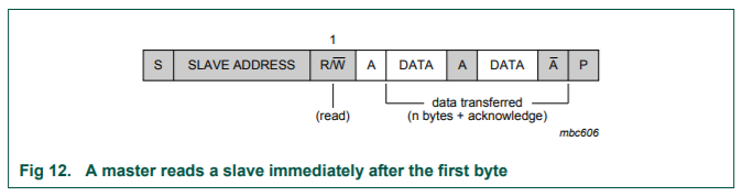

  • Hey Kumar,
    I think your I2C communication is working. The I2C spec states that in the case where the master reads the slave immediately after the first byte, the master will send a NACK just before the stop bit:
    Here is figure 12 it references:
    Your screenshot of the "Get_feature_set_version" command follows the same format that the I2C spec document describes. The NACK is expected.
    Also after looking at the SGP30 datasheet again, it looks like this is addressed in a few places:
    Figure 9 is below:
    The NACKs you are seeing are expected. Here is a link to the I2C spec document for reference
    Mitch
  • Hi Mitch,
    Thanks for input regarding the feature set,
    But do you have any suggestions as to why it fails during the read operation while trying to read measurements.
    It appears i am getting an ack when writing the measurement command and while trying read it sends addr nack. I have no clue why this happens.
    Any inputs on this?.
    Kumar
  • Hi Mitch,
    My understanding now is that while doing measurement read , as per the data sheet once the measurement command (0x2008) is issued, the sensor needs 10-12 ms to complete and be ready to transfer the data to the mcu.
    Is lack of delay the the reason why when it tries to read the data it fails with A-NACK.? I am also not sure if library code below handles the delay that is required by the sensor, I have also modified the library and have sgp30 communicate with cc430 but do you have any suggestions / workaround without changes to library.

  • Hi Kumar,
    Yes this makes sense. This explains why you get the A-NACK in this scenario, but not when you issue the Get_feature_set_version command. One workaround I can think of is to trigger a timer to count to 12ms after you send the Measure_air_quality command. Once this timer counts to 12ms, send the read command. You can implement this however you see fit (with flag variables, etc). This will require SW changes to your application code, but you shouldn't have to make changes in the I2C library.
    Mitch
