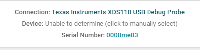

    I have several XDS110 standalone debug probes. They appear in Uniflash like this:
    So, I click on "click to manually select", select CC1352P in my case, and then the window moves to a debugger selection. HERE - if I click on "Edit", I can see that the serial number of the debugger that I have chosen above, was not added, instead the "Only one XDS110 installed" option is active:
    But, as I said, it's no problem, more of a feature request nature!
