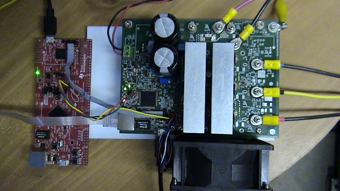

Part Number: TM4C1294KCPDT
It is clear that EMI entering via ADC channels is attacking USB, EMACK and GPTM edge counts. Oddly 3" to 6" connect wires X11 header to DC inverter masked over EMI issue, a custom PCB engineer is left to contend with. The proximity of MCU to EMI entering AINx channels is verified somehow enters VDD/LDO or the AHB and attack certain peripherals. No matter the bulk capacitance added on VDD pins there is no improvement to reduce inductive EMI.
The remedy to avert SCR latch up of USB0, PHY0 includes changing decoupling capacitance values on AINx channels 200pf reduced to 100pf or less. How is allowing more EMI to enter MCU stopping PHY latch up but then immediately crashes USB0 and effects GPTM edge counts? The EVM X11 Booster pack headers and OTG port are both immune to very same EMI source. We do not have the proper laboratory environment to uncover what the difference is.
Has TI considered updating TM4C1294 design guide as how to protect MCU exposed proximity to EMI source such as a DC inverter? Again the EVM X11, Booster Pack headers misleads engineers TM4C1294 MCU is mostly immune to EMI as OTG, PHY, GPTM edge counters are not effected by the very same EMI source.

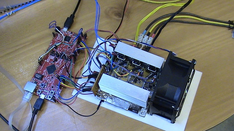

    The custom PCB works great up to 24vdc yet the ADC only on high EMI channels requires >400us settling to get true results. Bus voltage ADC samples >82vdc remain no problem and succeed >25us PWM triggering converter settling. How can that be no problem but using GPTM to trigger ADC samples on EMI channels require >400us settling? Something is causing the ADC to converter to misbehave and halt USB data transfer at the same time.
    Yet three PWM generators keep going like it's no body's business. However GPTM edge counts go bonkers at the same time PWM is running motor flawlessly. Another GPTM 120Mhz clocked one shot creates the FOC commutation codes from those EMF samples @25us without a single fault. If EMI effects one GPTM it should effect all GMTM equally, right?
    EVM channels were 6" wire distance from ADC input. Custom PCB has ferrite beads & 1 megohm series resistors added to EMI channels reduces transients, not block them. Past clamping channels Schottky +3v3 on EVM made no difference reducing transients peaks >4v. Perhaps an MOV might prove better than 1ns clamping 3v3 TVS? OnSemi support said their ESD 3v3 TVS would not clamp below 5v and we needed a TVS zener they no long make. How about TI do they make a fast 3v3 TVS clamps below +5v transinets?
  • You might consider using twisted pairs on your cables between the EVM and your board. The signal wire should be twisted with a ground wire. This will greatly reduce the size of the antenna loop which will reduce the amount of energy picked up in the cables.
  • Bob

    You have misunderstood EVM driven inverter already had 6" twisted wires, works without issues up to 165vdc. It is the custom PCB where the MCU mounted local to DC inverter, odder issues >24vdc supply occur.
    Surely there is something can be done to reduce ADC/USB intrusion of PWM SNR and correct several issues one stone?
    That was an older picture and had thought it the newer version with twisted wires. You were correct the PWM and EMF wires were twisted pair, EVM side GND of EMF wires were left un-connected.
    BTW the EVM booster headers are all little antennas sticking up in the air. So it is difficult to understand how they escaped the very same EMI that plagues the custom PCB. My gut feeling is the proximity of MCU to high voltage source is the bigger issue at hand.
