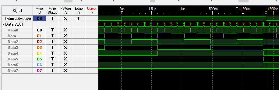

    As I mentioned earlier, I want to generate a DMA request on any rising or falling edges for several input bit s to port M GPIO pins.  Using DMA Ping-Pong with AbrSize = 1, for each edge detected, I’ll transfer a single copy of the port’s data register into a DMA buffer.  I do not want to interrupt the CPU when the DMA starts.  Nor do I want to interrupt the CPU when the DMA finishes.

  • Sorry for the delay in getting back to you, but I thought an example might be more helpful for you. It took a while to get working (too many interruptions.)
    I have attached a .zip file that contains two Code Composer project. Both run on an EK-TM4C1294XL Launchpad. The first project, 8BitPortMOut, simply writes an infinite number of incrementing 8-bit values out GPIO port M. The second project, 8BitPortMIn, use the uDMA to capture the changing values on Port M. The M ports of the two launchpads are connected by 8 wires plus a ground wire.
    /cfs-file/__key/communityserver-discussions-components-files/908/8BitPortM.zip
    Looking at the first logic analyzer picture, you can see that the first EVM was outputting values roughly every 110nS. Also note, that sometimes there was a few nanosecond delay between the transition on one signal and the transition of another for the same count. In my test case, I never saw an extra capture, or missed a capture. The distinct values came far enough apart that all could be captured, and the edges came close enough together that multiple DMA reads were not generated for a single count.
    My example used ping-pong mode of the uDMA with two 1024 byte buffers. I get an interrupt after each buffer is filled. If I have not reset the DMA transfer before the second buffer is filled, I will miss some of the counts. In my routine, the main loop is doing nothing so interrupts were serviced almost immediately. I toggled an extra pin to show when I was in the interrupt routine. The time between interrupts was 110.5uS.
    The length of the interrupt routine was 2.34uS.
