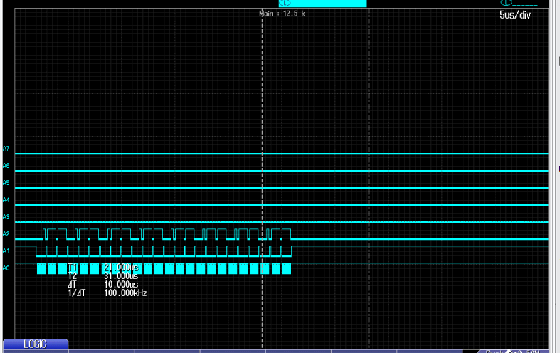

I am configuring Port M pins to be output pins so that I can output some pulses to an external ADC chip.
I have configured the port as shown in the following, there is no compiler error or warning however I can not see any pulses on PM4 and PM5 pins.

I dont know what, I am missing ?
Following is the snapshot of my logic analyzer, showing A3 and A4 (connected to PM4 and PM5 respectively) are low.
