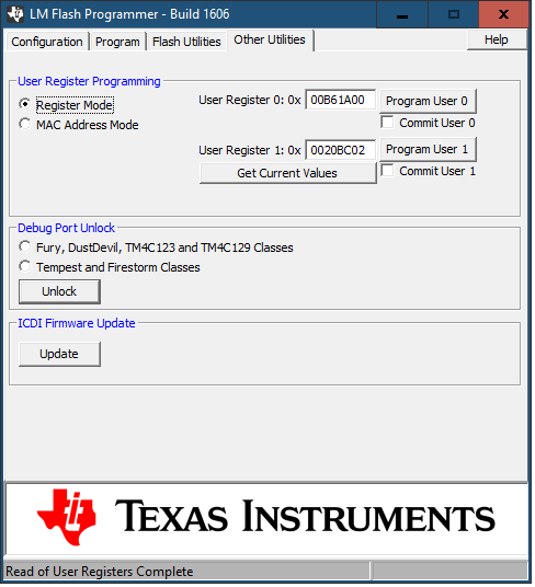

    Using MAC address in flash
    Perhaps program the USER0/1 register (USER_REGn) for the MAC with LM Flash tool. MAC address to exist in flash may not be expected by source code.
     I am no sure if I understood the process. With LM Flash Programmer I can get the MAC Address. Take a look at the attached image.
     Should I configure a different MAC address?

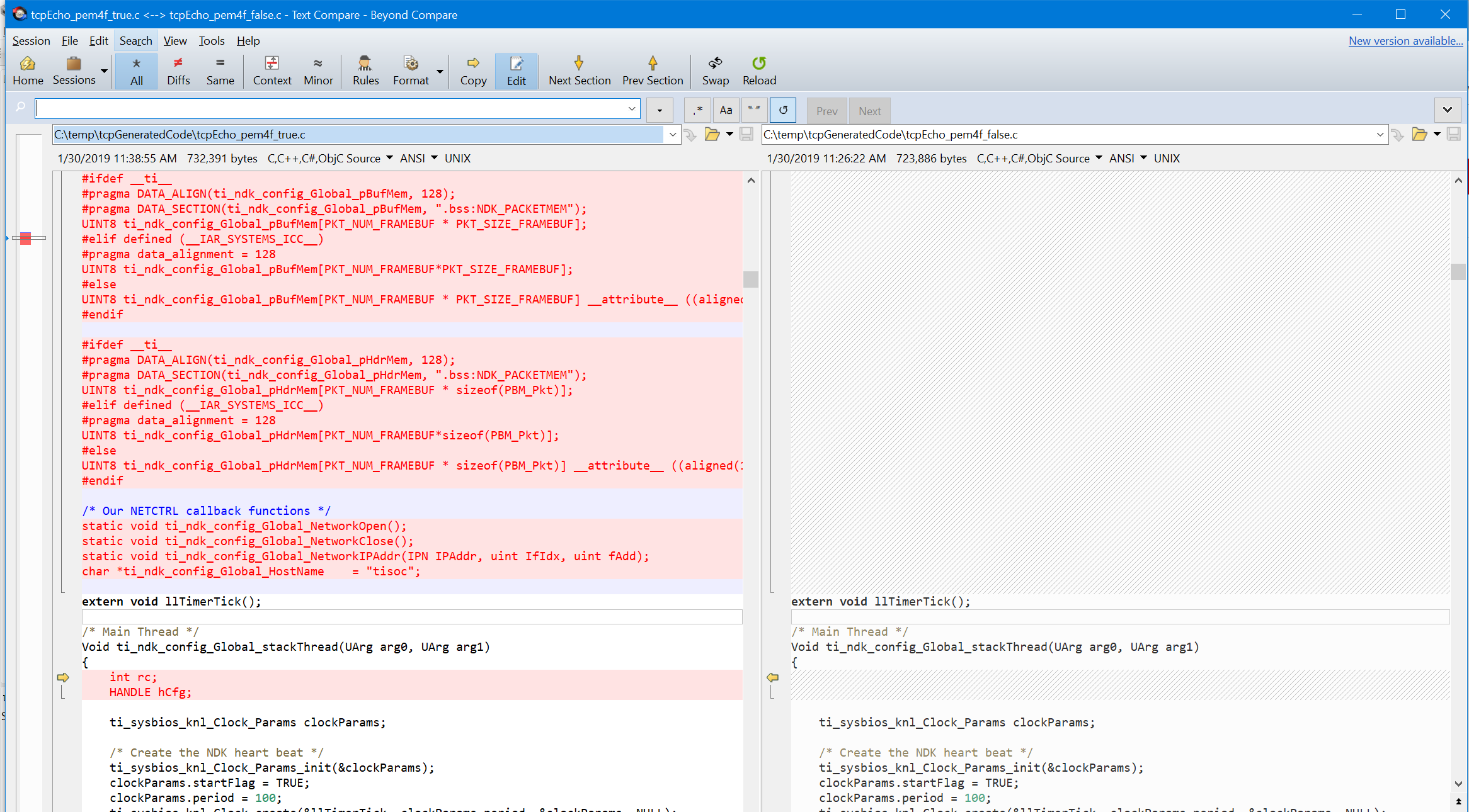

  • Leandro,
    The problem you are having is that the networking code is still being generated. So the network is trying to be opened by you and the generated code.
    Do the following
    1. Build the big generated .c file with this in the .cfg: Global.enableCodeGeneration = true;
    2. Save the generated file some where other than in the project and add "true" to make it obvious (e.g. C:\temp\tcpEcho_pem4f_true.c
    3. Change to Global.enableCodeGeneration = false; in the .cfg.
    4. Now compare the generated file with tcpEcho_pem4f_true.c. You'll see the stuff you need to supply.
    Note: there is still the ti_ndk_config_Global_stackThread task. It just creates the clock for you (sorry, I misled you on this one...I forgot it did this).
  • If the MAC matches what you entered in LM Flash it should be ok. You must commit the MAC or it will return to 0x0 on next POR. Also check MAC address mode to see if it looks like you expect it should.
