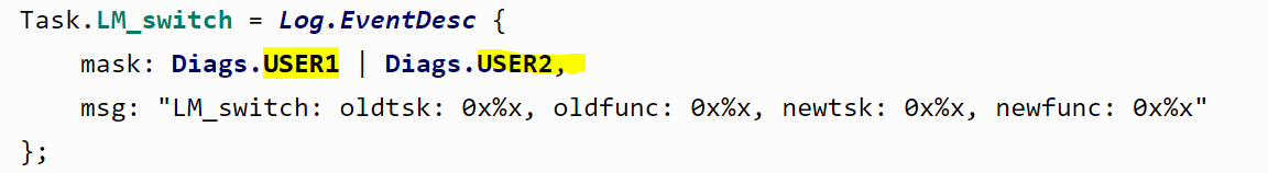

    This makes one logger instance that all modules use. You can look in the cdoc for a module to see what diags mask needs to be enabled. For example, here is the Task context switch
    Note: LoggerBuf is not supported by LoggingSetup. When you use LoggerBuf, you have to manually do all the things that LoggingSetup was doing for you (e.g. creating logger instances, enabling module's diag mask, etc.
    Note: you can use multiple logger instances and assign then specifically to certain modules. That's what LoggingSetup does (xdc.runtime.Main gets one, BIOS's Load module gets one and the rest of the BIOS modules get one). This is controlled by the <Module>.common$.logger field. If it is not explicitly set, it inherits from xdc.runtime.Defaults.
    Note: the runtime code does not change. It still uses Log_XYZ.
