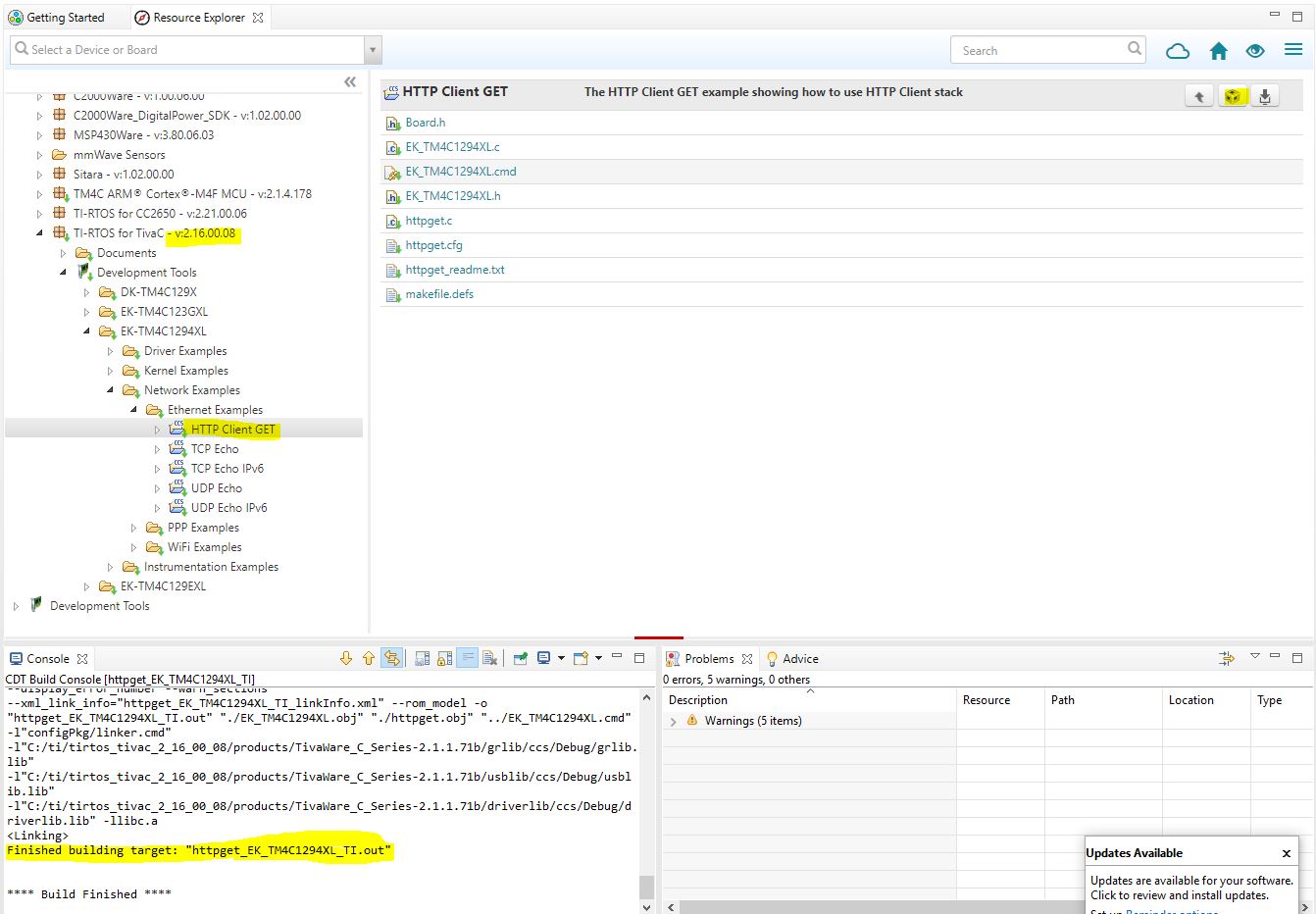

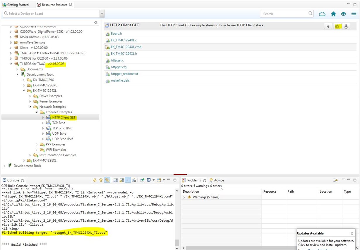

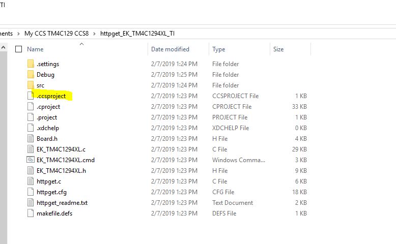

HI,
Yes, you are correct that the resource explorer is only supported in the latest CCS version 8. I just tried to import the HTTPS client GET project from the resource explorer and don't have issue with it and I was able to build the CCS project right away. See below. The 2.16.00.08 is the latest version for Tiva while you might find newer versions of TIRTOS supporting other TI devices.
Here is the CCS project but I will suggest you try to import again from Resource Explorer.

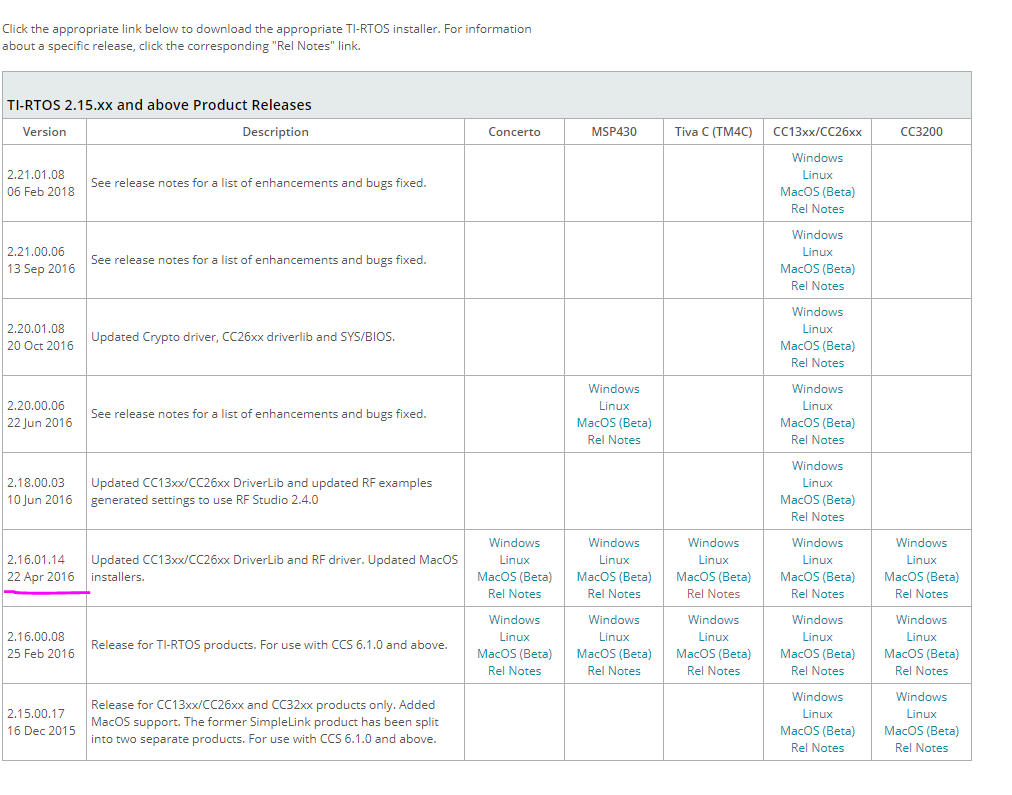

Also, when I click on TIRTOS downloads I see this picture (below). I have been using the newer version ever since it was released along with CCS7. Why isn't it shown in the resource explorer?
