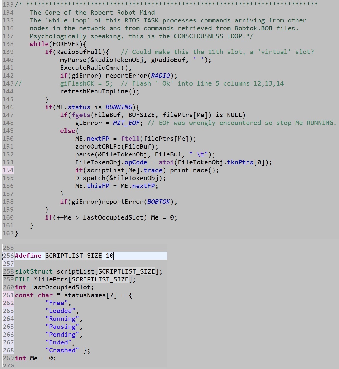

Using CCS I have written a C program to control a robot/metal lathe/chop-saw.
All of the I/O is interrupt driven and works very well.
The heart of the program consists of a command string interpreter.
The command strings can arrive by serial port or can be read from files on the SD card.
The interpreter reads commands round robin fashion from up to 10 open files and uses each file's position pointer as a virtual "program counter" so that such commands as ONGOTO, GOSUB, GOTO etc. have been quite easily implemented.
In effect it is a "multi tasking" interpreter. The whole thing works extremely well interpreting almost 5000 commands/sec, more than fast enough.

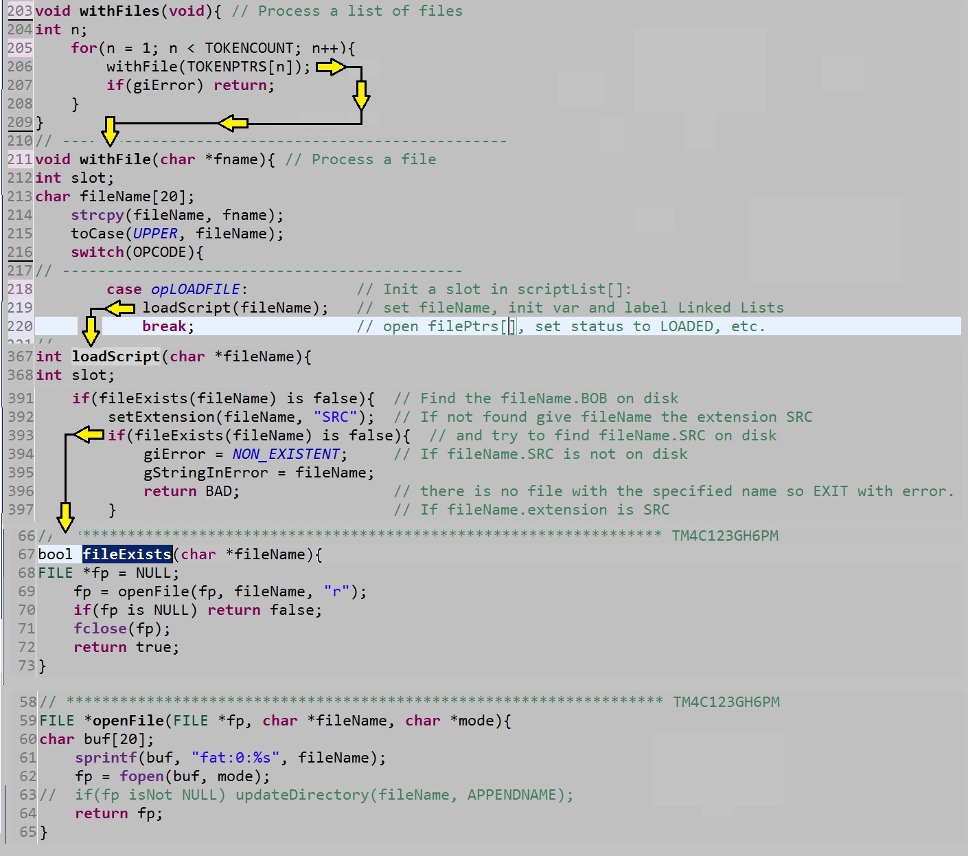

BUT, a problem arises whenever I try to open more than 7 files, i.e. a NULL is returned when it tries to open an 8th file.
Either I haven't specified enough of the right kind of RAM  in .CFG (stack or heap or wherever it is that the file buffers are located) OR
my attempts to change _FS_SHARE in ffconf.h are not taking effect even though I click on 'Build All' and 'Clean... Build the entire workspace"
What should I do to allow opening of up to 15 files concurrently?
Your help will be greatly appreciated. Thanks. Dave

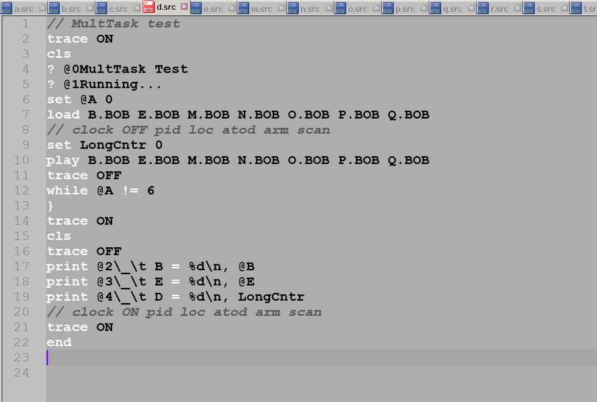

p.s. Here's a sample of code my interpreter processes. When 'load' tries to open Q.BOB a NULL is returned.

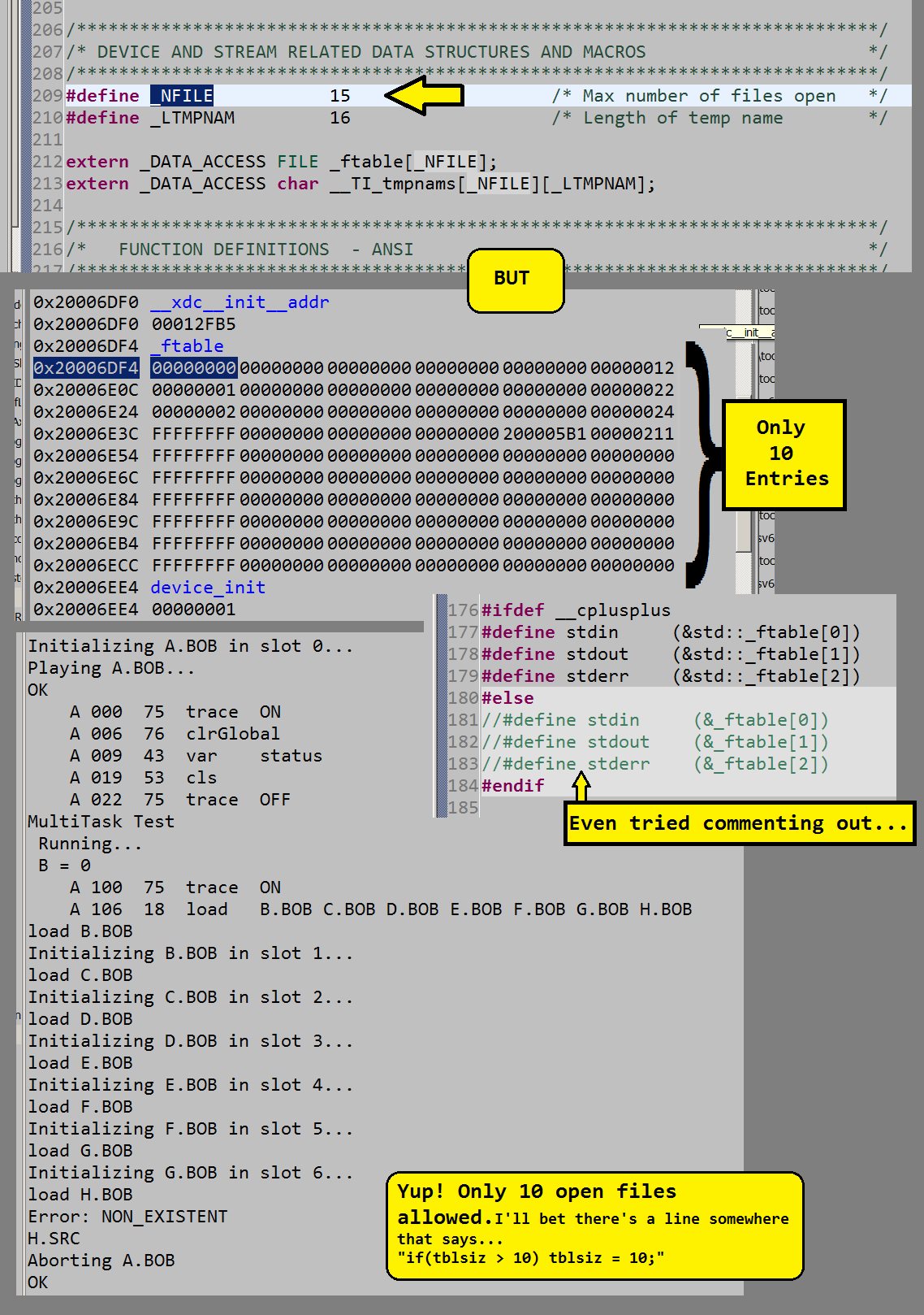

  • Hi David,
    _FS_SHARE is for the number of threads that can share a file....not the number of unique files that be open. That is unlimited (per FatFS website)
    Filesystem type: FAT, FAT32(rev0.0) and exFAT(rev1.0).
    Number of open files: Unlimited. (depends on available memory)
    Number of volumes: Upto 10.
    Volume size: Upto 2 TB at 512 bytes/sector.
    File size: Upto 4 GB - 1 on FAT volume and virtually unlimited on exFAT volume.
    Cluster size: Upto 128 sectors on FAT volume and upto 16 MB on exFAT volume.
    Sector size: 512, 1024, 2048 and 4096 bytes.
    I think something else is going on. In a task, can you just have a loop that opens N unique files and see if that works?

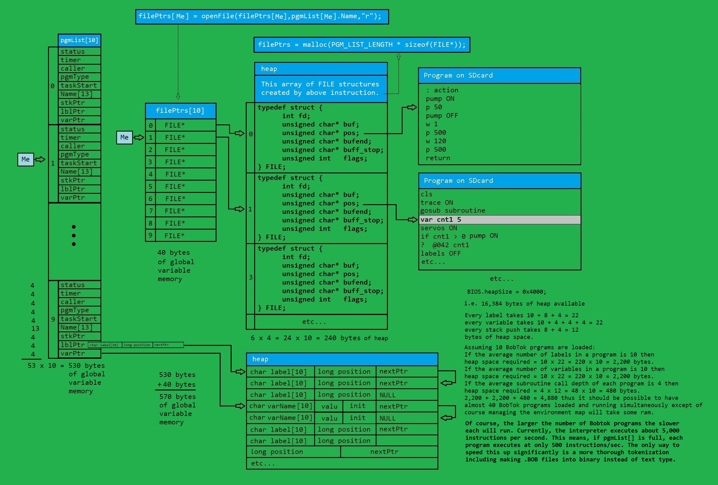

  • Hi Todd, re: "In a task, can you just have a loop that opens N unique files and see if that works?"
    Yes, this is what my program is doing...
    Now:
    Program.stack = 2048;
    task0Params.stackSize = 5000; (My one and only Task)
    BIOS.heapSize = 15360;
    SRAM Memory Allocation is 32,572(99%)
    More possibly relevant...
    I can 'load' 7 files into scriptList[]. Attempting to load an 8th causes 'false' to return from fileExists().

    I tested this by swapping the order of P.BOB and Q.BOB in the 'load' parameter list.
    In that case Q.BOB gets loaded and fileExists() returns false when trying to open P.BOB.
    My heap use is practically non existent.

    Here's a quite out of date image (but still capturing the essence) of what I'm attempting...
    Thanks Alan

  • As you are using the stand C library APIs, I think you're bumping into a C RTS library FOPEN_MAX limitation.
    If you can find the stdio.h file you're using, search for the definition of FOPEN_MAX. This should give you an idea of what needs to be done to increase the number of files you can have open simultaneously. I think it is likely to be 10. In your case, the first 3 are taken up by STDIN, STDOUT, and STDERR. Leaving 7 left for you. But that's just an educated guess...
    I found this info here:
    www.cplusplus.com/.../
    Alan
  • Hi Alan,
    Yes, FOPEN_MAX was set to 10. I changed it to 15... Here's a picture of the situation...
    In the mean time I've been working out the bugs and it's perfect now! (a statement that always makes my buddy laugh).
    I know, eventually, we'll figure it out.
    Thanks for the suggestions. I'm just about to read the 'cplusplus' link you gave.
    Cheers
    Dave
    I think you have to change _NSTREAM as well as _NFILE -  see Compiler/TMS320C6674: RTFS File Descriptors > 17 open at a time?
    The referenced thread is for the TI C6000 compiler, but think the same principal applies to the TI ARM compiler.
    Given that the picture shows that _ftable only has 10 entries it looks like the compiler run time library wasn't re-built after _NFILE was changed.
    When a source file is changed in the compiler run time library source directory is changed, the library isn't automatically re-built when you build your CCS project. To force the run time library to be rebuilt after _NFILE and _NSTREAM have been increased:
    a. In the linker .map file of your project find a line of the following form which identifies which library file is used from the compiler:
        /home/mr_halfword/ti/ccs830/ccsv8/tools/compiler/ti-cgt-arm_18.1.4.LTS/lib/rtsv7M4_T_le_v4SPD16_eabi.lib
    b. Delete the above file.
    c. Re-build your CCS project and there should be output of the following form from the linker indicating that the library is being built:
    <Linking>
    warning #10366-D: automatic library build: using library "/home/mr_halfword/ti/ccs830/ccsv8/tools/compiler/ti-cgt-arm_18.1.4.LTS/lib/rtsv7M4_T_le_v4SPD16_eabi.lib" for the first time, so it must be built.  This may take a few minutes.
    Creating library /tmp/TI_MKLIB57mlHN/rtsv7M4_T_le_v4SPD16_eabi.lib
    See Mklib for more information on how the run time library is built.
  • Hi Chester,
    Yaaay! That worked. Thanks ever so much Chester.
    What I did:
    Found the directory containing the files 'file.h' and 'stdio.h' in
    C:\ti\ccsv6\tools\compiler\ti-cgt-arm_5.2.5\lib\src
    and
    edited 'stdio.h' changing the _NFILE entry value from 10 to 15.
    edited 'file.h' changing the _NSTREAM entry value from 10 to 15.
    In directory: C:\ti\ccsv6\tools\compiler\ti-cgt-arm_5.2.5\lib
    copied, renamed then deleted file:
    In Code Composer Studio.Project.Clean selected my project, pressed the "Build the entire workspace" option button and clicked the OK button.
    Then I clicked the 'Debug' button to burn the project into the TM4C123GH6PM flash.
    When I opened the Memory Browser and entered '_ftable', voila! - there were the fifteen entries. Wheeeeee.
