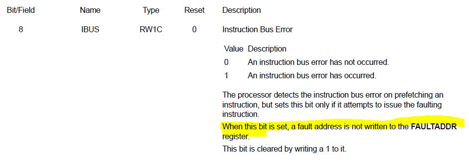

During execution of instructions most of the time fault isr is getting generated.
In fault register IBUS bit is set.
I have tried increasing heap and stack memory and giving delays.
Why Instruction bus error is generated?

    The IBUSERR is mostly due to the below possible reasons. I can't image running at different frequency can solve the problem. Other than IBUS bit do you see any other bits set? Do you have another chip/board that you can try and can you repeat the same problem?
    a) Branch to invalid memory regions for example caused by incorrect function pointers.
    b) Invalid return due to corrupted stack pointer or stack content.
    c) Incorrect entry in the exception vector table.
    Here is one app note that explains how to debug a software fault situation.
    www.ti.com/.../spma043.pdf

  • Hi Akshay,
     When the IBUS bit is set, the fault address is ot written to the FAULTADDR register. In addition, the bit 15 (BFARV) of the NVIC_FAULT_STAT also indicates the FAULTADDR register is not a valid fault address. Therefore, the 0xE000EDF8 is not the source of the fault.
      You have not answered me if you have tried a different chip or board and can you repeat the same problem? Can you try on the LaunchPad ad can you repeat the same problem
      Can you show how you configure the system clock?
