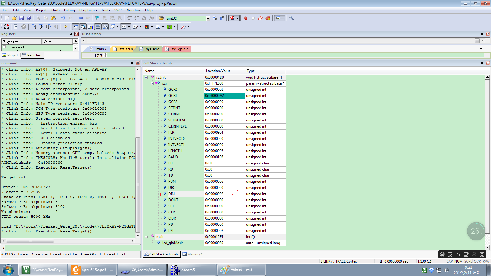

Hello everyone, I am using the TMS570LS1227's two-Channel SCI interface to send data at the same time. The SCI/LIN transmission data is normal, but another single SCI interface is not sent properly, and its TX pin is always low! Anyone who can answer this question? thank you very much!
The following is my code and the contents of the relevant registers after initialization is completed.
