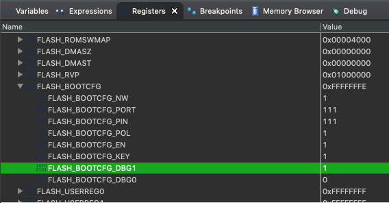

I use TM4C1294NCPDT along with XDS100V3 (EMBEST). The connection is tested and it works, I am able to:
1. Load the image to microcontroller
2. Put breakpoints and they are reached
3.Step through each line of code
I do not why with every reset the ROM boot loader is invoked. I mean, I always see the message  "firmware update" on Device Manager.
It seems that the ROM boot loader ignores the "valid application" (0x00000004 is not 0xFFFFFFFF), previously programmed.
I suspect the BOOTCFG has a wrong configuration (did not try to read its config so far).
Might be there any other cause why this behavior ?
