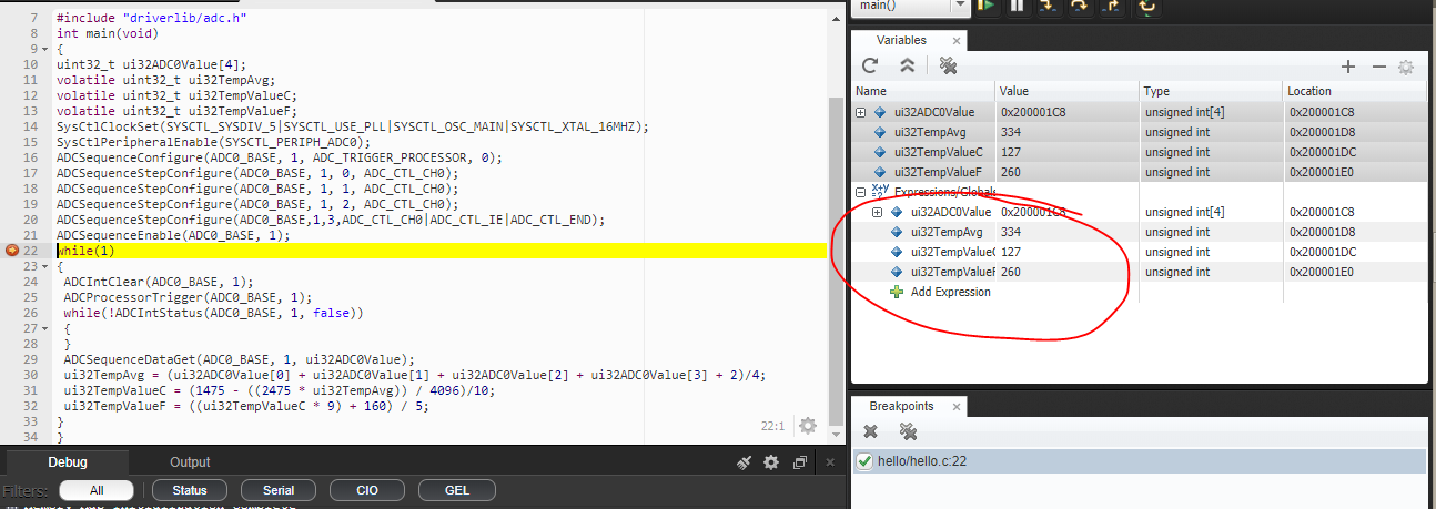

hello.
I am trying to interface LM35 temperature sensor with Launchpad.
I have been following the Tiva Launchpad workshop documentation availeble on the internet.
As I could only get the code for the internal temperature sensor, I modified it as suggested by Ralph Jacobi. This is my code:

Also, I connected the output pin of the sensor to PE_3 pin.
But on observing the breakpoint, I get the readings even if this pin (PE_3) is disconnected!
I am unable to figure out the origin of this miscellaneous reading. (shown in the below screenshot)
Thank you in advance!
  • I don't see anywhere in your code where you configured PE3 to be an analog input pin. You should have these statements:
      SysCtlPeripheralEnable(SYSCTL_PERIPH_GPIOE);   //Enables the clock to PORT E
      GPIOPinTypeADC(GPIO_PORTE_BASE, GPIO_PIN_3);
    Without these statements you are converting the voltage on an internal floating node.
  • Hello Mr. Bob,
    Thank you for the swift reply.
    Do you refer to PE_3 ?
    I added the lines of code you suggested. But, still getting the same readings.
    How should I differentiate whether the readings are from the internal temperature sensor or the external one ?

  • Yes, sorry. I meant PE3. I have corrected my earlier post. Did you use GPIO_PIN_3?
