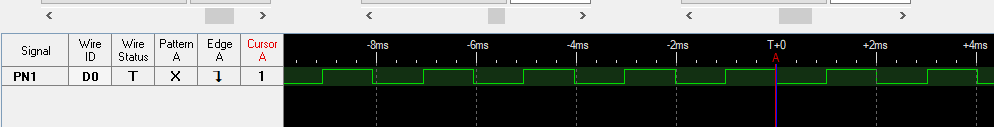

  • I don't know what the problem was. I took your code and changed the prescale to 120 and the timer preload value to 1000 and have a 1mS periodic interrupt.

  • Hi Bob Crosby sir,
    Now I got output as per you posted. Thank you sir for your quick response.
    Venkatadri.
