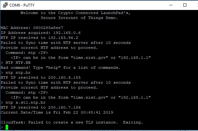

I am trying to execute the Secure IoT out-of-box demo of EK-TM4C129EXL but I'm facing the following problem??

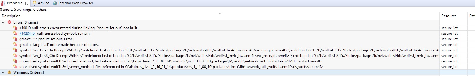

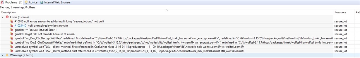

I'm also trying to compile the Secure IoT project without success. After 1 day lost trying to compile the project I checked this post.

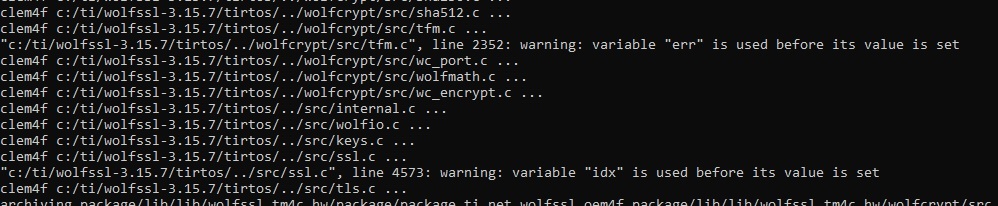

First of all, I was able to compile the  wolfSSL with some warnings as showed below. Tried 2 versions!

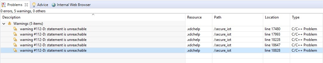

Second, I was able to compile the project but I also got some warnings in the secure_iot_pem4f.c file.

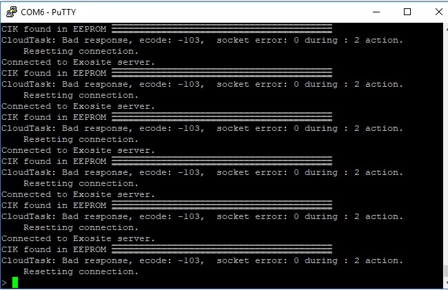

Then after programming the board freezed after connected to the NTP server, but the LED D2 still blinking.

  • wolfSSL v3.10.2 (the project compile and occur the error above) and 3.15.7 (same warnings as the v3.10.2 and ERROR compiling below)
  • Hi Vinicius,
    You'll need to contact WolfSSL about their issues. I know the newer WolfSSL versions are having an issue with TI-RTOS for TivaC. Can you try the 3.8.0 version of WolfSLL? That's the one we validated TI-RTOS with.
    Regarding the compiler warnings "statement is unreachable", this occurs in newer versions of the TI compiler with TI-RTOS. While annoying, it can be ignored or you can move back to the version that TI-RTOS was validated with ti-cgt-arm_5.2.5.
