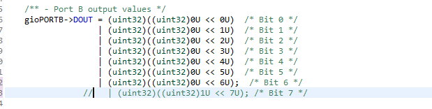

during of exection of gioInit() function  DClr is enabling(below is image), am suspecting due to of this I am not able to set the particular GPIO.

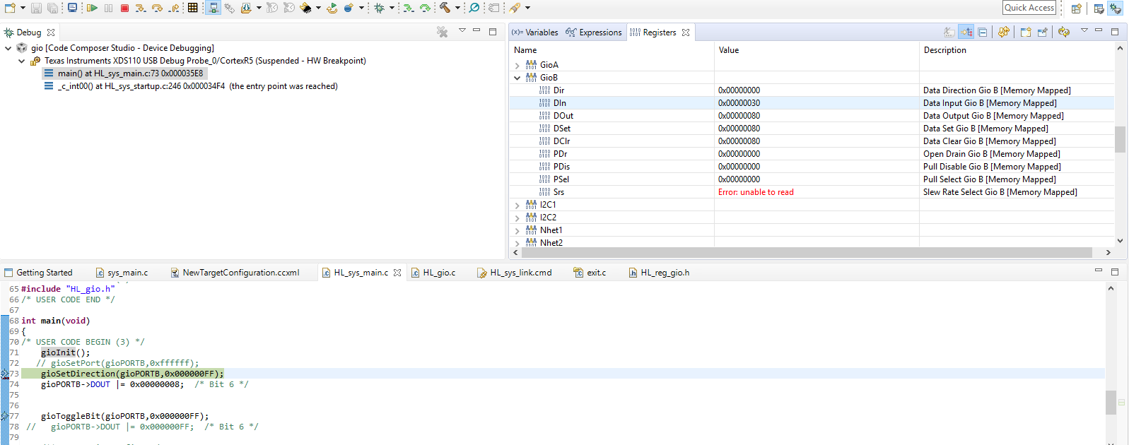

commented GPIO direction in gioInit(),image is below
and changed program to below

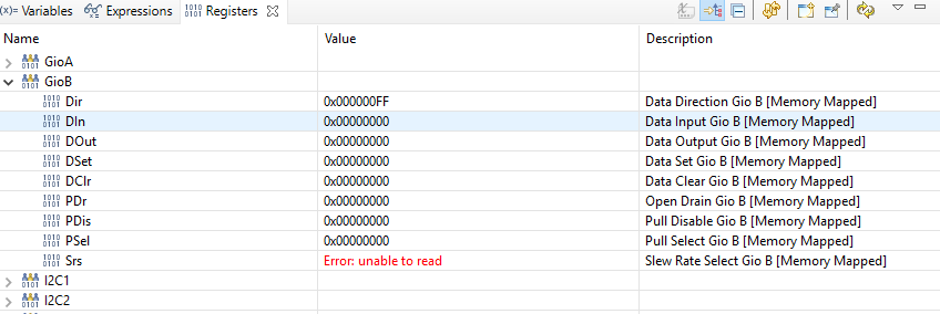

in this situation not able to set and direction of gpio, image is below

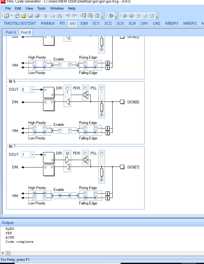

 also attaching halcogen image.

    Please try the following :
    1. Check PINMUX tab in HALCoGen, if GIOB is enabled
    2. Try this code :
    int main(void)
    gioInit();
    gioToggleBit(gioPORTB,7U);
    Since the DOUT and DIR values are configured in HALCoGen we do not need to manually set it again in main() as these values will be set in gioInit();
    Akshay
    Please do as follows:
    In HALCoGen:
    - Enable GIO Driver in Driver Tab. Disable all others;
    - Enable GIOB checkbox in PINMUX Tab;
    - Set data direction for desired pins - for output chech DIR checkbox, for input uncheck DIR checkbox;
    - Set initial value for desired pin if it is configured as output with selecting '0' or '1' in DOUT dropdown field;
    - Generate code.
    In CCS:
    - call gioInit();
    - call some API for driving the desired pin;
    for example:
    If you want to set GIOB7 high: gioSetBit(gioPORTB, 7, 1);
    If you want to set GIOB7 low: gioSetBit(gioPORTB, 7, 0);
    if you want to toggle GIOB7: gioToggleBit(gioPORTB, 7);
    if later in your program you want to set GIOB7 as input and all other pins as output then call: gioSetDirection(gioPORTB, 0x0000007F);
    Miro
  • Hi Miroslav,
    thanks for reply, now GIO is toggling.
    thanks again.
