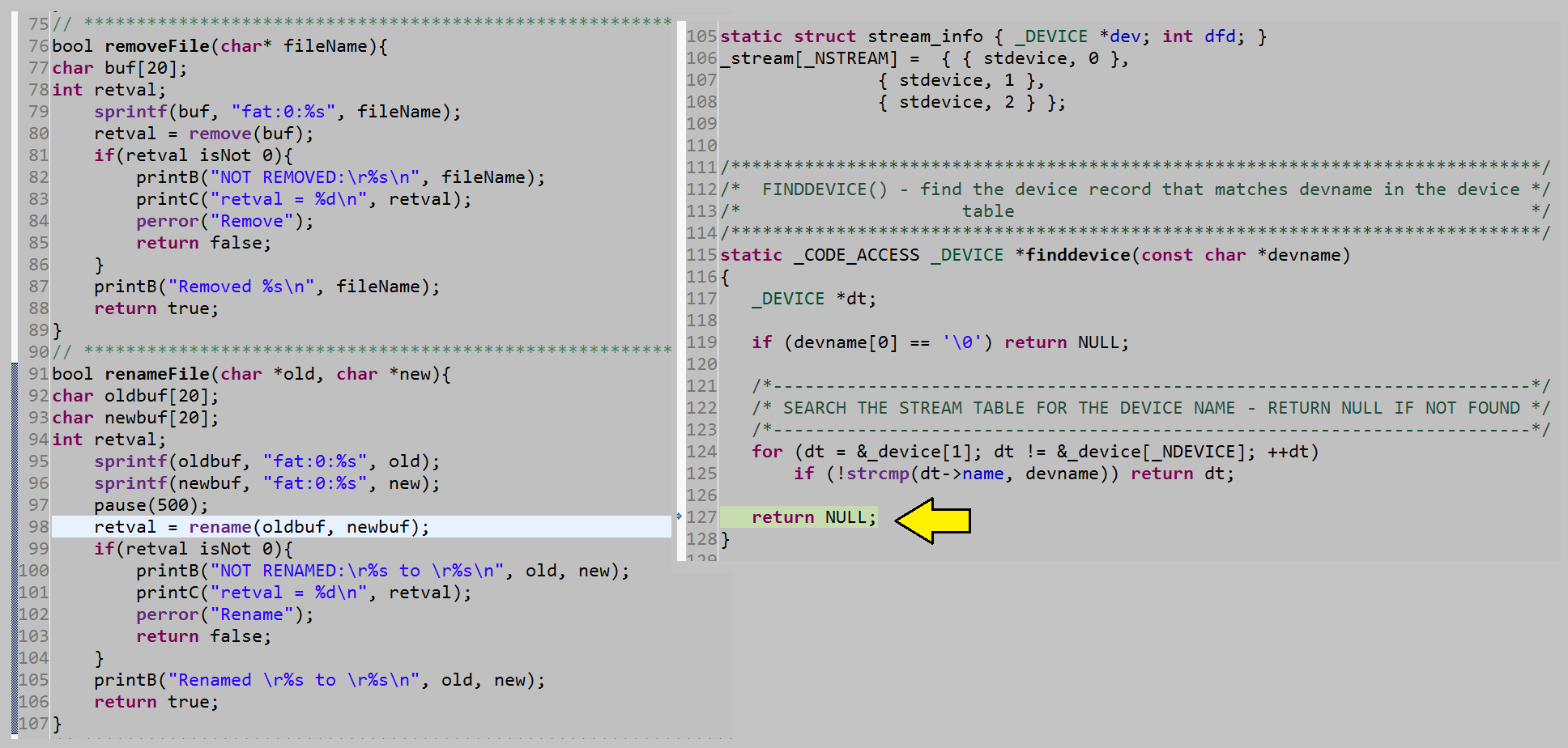

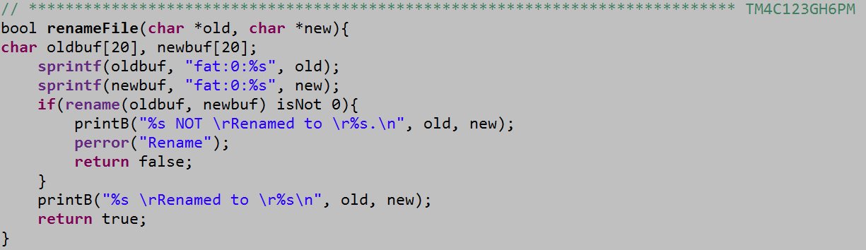

Rename(old, new) used to work but I've done something and now it doesn't.
I've tried naked files and this...
Results...

  • Hi David,
    I'm not an expert in FatFS but have some questions:
    1. Are you using the native C library function rename() without TI-RTOS or are you making use of TI-RTOS FatFS?
    2. Is printB your own print function?
    3. You said rename() used to work? Do you remember what exactly did you change before it started to not work? Can you not revert back?
  • Hi Charles,
    1. I am using TI-RTOS FatFS.
    2. Yes, printB is my function to send formatted data both out UART1 to my Remote Controller and to the debug console screen.
    3. It's been a few years since I worked on the part of the program that used 'rename()' so I can't remember anything about it. In my current work I've just added a second pass to my tokenize() routine (which 'tokenizes' source code in my 'robot control language' interpreter in an effort to speed up interpretation). When 'running', the interpreter reads a line at a time from a file on SDcard and uses the FILE.pos (via ftell()) as a virtual 'program counter'. My 'language' supports 'while wend' loops and 'if endif' statements. The first iteration of the interpreter had to read and discard all the lines between the 'while' and the 'wend' in order to find the 'wend' when the truth condition of the 'while' became false. Very slow. The second pass of the tokenizer finds the 'wend' then adds its address to the 'tokenized' form of the 'while' instruction so that during interpretation that value is used to 'seek' the file pointer to the location in the file which is the line after the 'wend'. Much faster. The first pass of the tokenizer inputs fileName.SRC and outputs a tokenized file called fileName.BOB and sets a need2ndPass flag if a 'while' or 'if' instruction is encountered. The second pass takes fileName.BOB as input and outputs fileName.TXT. When the second pass completes it 'remove()s fileName.BOB and 'rename()s' fileName.TXT tofileName.BOB. And that's why I need 'rename' to work.
    The last thing I did that may have affected the system was: The interpreter is actually a 'multitasking' interpreter designed to read and interpret lines from up to ten open files in round robin fashion (implemented by means of ten 'virtual CPUs'). But the default state of the system limited _ftable to only ten entries three of which were used by stdin, stdout and stderr thus limiting me to only seven concurrently open files. With help from another TI expert I was able to increase _ftable size to 15 entries. To do this I had to change entries in 'stdio.h' and 'file.h' then rebuild the library. But during my preliminary floundering I may have wrongly changed settings in 'ffconf.h', 'stdio.h' and 'file.h' etc.
    I've just reviewed these files and everything looks right (as far as my limited understanding was able to determine) and rebuilt the library again. Sadly, the problem persists.
    What do you think?
    Dave

  • Hi Dave,
    1. What version SDK is this project based on?
    2. Do you know what value rename() is returning? Have you tried stepping into that code to observe what happens?
    3. Does this issue occur consistently, or is it intermittent?
    4. You mentioned you had to rebuild a library to work with more files at once. Have you tried using the original library to see if that causes the issue to go away? That would help us start to isolate the issue.
    Sean
  • Hello Sean,
    About:
    1. I don't know. I think it's not based on an SDK.
    2. rename() is returning -1.
    3 The issue is absolutely consistent.
    4 In 'stdio.h' changed the _NFILE entry value from 10 to 15.
    'file.h' changed the _NSTREAM entry value from 10 to 15.
    I was advised to delete rtsv7M4_T_le_v4SPD16_eabi.lib to force a rebuild of it which would incorporate my changes, and so I did and it worked. _ftable now has 15 entries.
    RemoveFile() works fine, I stepped thru it and saw where it returned 0.
    I stepped thru renameFile(), couldn't make sense of most of the assembly (not familiar with ARM). I did see where it returned -1 somewhat after finddevice() returned null (as shown below).
    Are there some files I should send you?
    Thanks for your help.
    Cheers,
    Dave

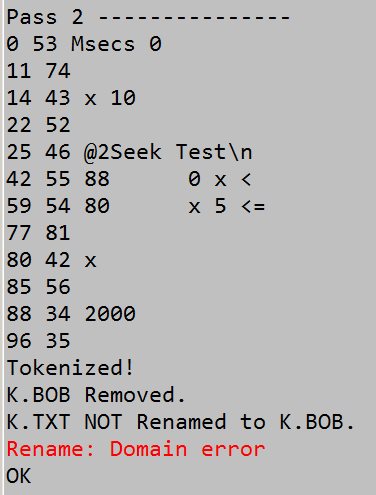

    p.s. Here is how my debug console looks after the robot boots and I tell it to tokenize file k.src
    (things line up better on the debug screen than it appears here)...

    Removed K.BOB
    NOT RENAMED:TMP.BOB to K.BOB
    retval = -1
    Rename: Domain error
    Tokenized K.SRC

    I stepped thru rename() in assembler on one screen and observed lowlevel.c on another screen trying to find the condition causing rename to fail. Here are my notes copypasted from both screens...
    ___________________________________________________________________________________
    void renameFile(char *old, char *new){ <--- my rename function
    char oldbuf[20];
    char newbuf[20];
    sprintf(oldbuf, "fat:0:%s", old);
    sprintf(newbuf, "fat:0:%s", new);
    if(rename(oldbuf, newbuf) isNot 0){... <--- disassembly starts
    rename():
    getdevice():
    finddevice():
    return NULL;
    dev = finddevice(devname); <--- dev is 'fat'
    return stdevice; /* the "standard" device - host I/O */
    old_dev = getdevice(&old_name); <--- old_dev is 'fat'
    new_dev = getdevice(&new_name); <--- new_dev is 'fat'
    if (old_dev != new_dev)
    result = (*(old_dev->RENAME)) (old_name, new_name);
    Can't find a source file at "/db/vtree/library/trees/zumaprod/zumaprod-f33/tirtos_tivac_2_12_01_33/products/bios_6_41_04_54/packages/ti/sysbios/fatfs/ffcio.c"
    Locate the file or edit the source lookup path to include its location.
    ffcio_rename():
    00013186: B508 push {r3, lr}
    00013188: F7F5FEF8 bl #0x8f7c
    f_rename():
    00008f7c: B570 push {r4, r5, r6, lr}
    00008fc8: F005F938 bl #0xe23c
    00008fcc: 1C04 adds r4, r0, #0
    00008fce: D059 beq $C$L173
    00008fd0: 2C04 cmp r4, #4
    00008fd2: D15A bne $C$L175 <--- r4 is 6, not 0
    $C$L175:
    0000908a: 9801 ldr r0, [sp, #4]
    0000908c: 4621 mov r1, r4
    0000908e: F009FEA5 bl #0x12ddc
    00009092: 4620 mov r0, r4
    00009094: B018 add sp, #0x60
    00009096: BD70 pop {r4, r5, r6, pc}
    0001318c: 2800 cmp r0, #0 <--- r0 is 6
    0001318e: BF14 ite ne
    00013190: F04F30FF mov.w r0, #-1 <--- this executes
    00013194: 2000 movs r0, #0
    00013196: BD08 pop {r3, pc}
    result = (*(old_dev->RENAME)) (old_name, new_name); <--- result is -1
    00002bb2: 4628 mov r0, r5
    00002bb4: BD3E pop {r1, r2, r3, r4, r5, pc}
    __TI_resource_unlock(__TI_LOCK_DEVICE_TBL);
    0000d95a: B928 cbnz r0, #0xd968 <--- r0 is -1
    104 printB("RENAME %s \rto %s \rFAILED\n", oldbuf, newbuf); <--- #0xd968 is here, FAIL

    Again, my function that calls rename():
    // **************************************************************** TM4C123GH6PM
    char oldbuf[20];
    char newbuf[20];
            printB("RENAME FAILED \r%s to %s\n", oldbuf, newbuf);
            perror("RENAME");
    //        return false;
        else
            printB("Renamed \r%s to \r%s\n", oldbuf, newbuf);
    //    return true;
    Which passes "fat:0:TMP.BOB" and "fat:0:K.BOB" to rename().
