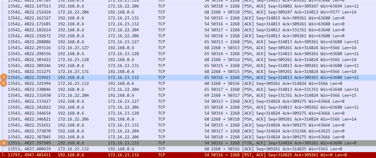

I have a problem, I use TM4C1294+non-OS+LWIP.
Because the original settings make TCP transfer slow,
I adjusted to 5ms, the code is as follows: (although this adjustment is really bad)
tcp_impl.h
#ifndef TCP_TMR_INTERVAL
//#define TCP_TMR_INTERVAL		250		/* The TCP timer interval in milliseconds. */
#define TCP_TMR_INTERVAL		5
#endif /* TCP_TMR_INTERVAL */
There are also polling sys_check_timeouts() every 5ms, in the lwIPServiceTimers().
Currently, every 5~10ms, the PC will communicate with the board once, and most of them run well.
But there will be a timeout in about an hour. (wireshark is shown below)
(1) The PC sends the query command to the board.
(2) Board reply ACK
(3) PC software can't wait for response data, perform close connection
May I ask what might happen?
Thank you.

    If you enable LWIIP debug UARTprtintf() messages (lwipopts.h) for TCP you will see a (Wait-Timeout) may occur sometimes during faster 5ms periods. It seems (lwiplib.c) also fails to handle OOSEQ timeout cleanup. I added call below to check condition LWIP seems to omit and slowed down timer once again. Out of sequence packets never get ACK response, TXD pbufs were once allocated. You can try to speed up (disable Nagle) for much faster transfers via Telnet and other RDP protocols, e.g. your client pcb pointer ->flags |= TF_NODELAY.
    What seems to occur, no remote SYNC response relate to lost frames for allocated pbufs taken from memory pool. That may also cause dropped frames messages, we need to reclaim (pbuf=Null) memory space or eventually crash TCP stack. It was unclear if LWIP1.4.1 was performing the call to reclaim OOSEQ memory space but it seem perhaps not. At lest fewer wait timeout messages seem to occur after adding call below.

  • BTW my: TCP_TMR_INTERVAL=325ms
    The GPTM 5ms interrupt increments LWIPTimer(5) polling semaphore @25ms. You can adjust number of desired periods (lwipopts.h) HOST_TMR_INTERVAL for TM4C129_HAL interrupt handler. I have two TCP stacks, LWIPTimer(5) 25ms interval works quite well. The LWIP timers are difficult to adjust but can be made to mesh into your higher application NVIC priorities by simple tweaks made to both intervals.
