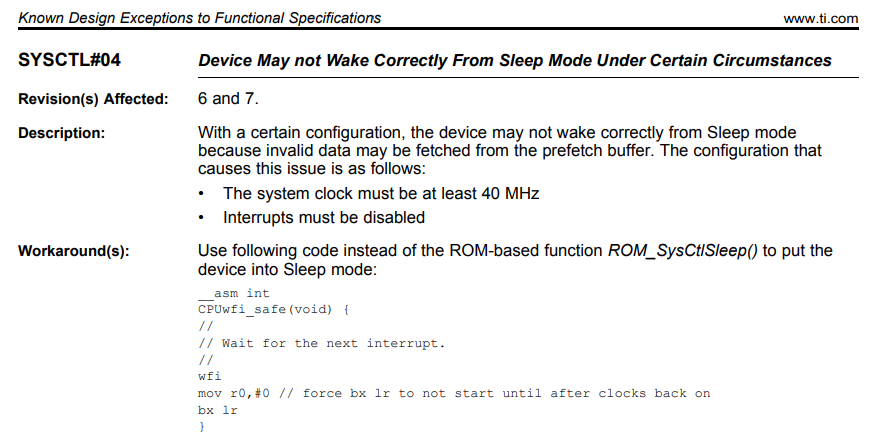

Part Number: TM4C1231H6PM
My system is running with FreeRTOS, it has interrupts and the system clock is 50MHz.
For this errata's requirement,
what does it mean by "Interrupt must be disabled" ?
Also, I would like to try to reproduce this errata on my system. Is there a way to quickly reproduce this? For example if there is a way to increase the likelihood of the system from not waking up from sleep mode due to this errata.
Any help is greatly appreciated. Thanks in advance.
